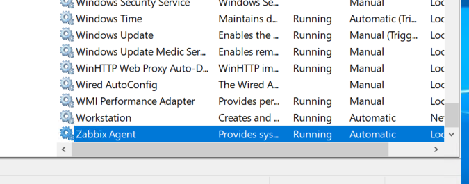

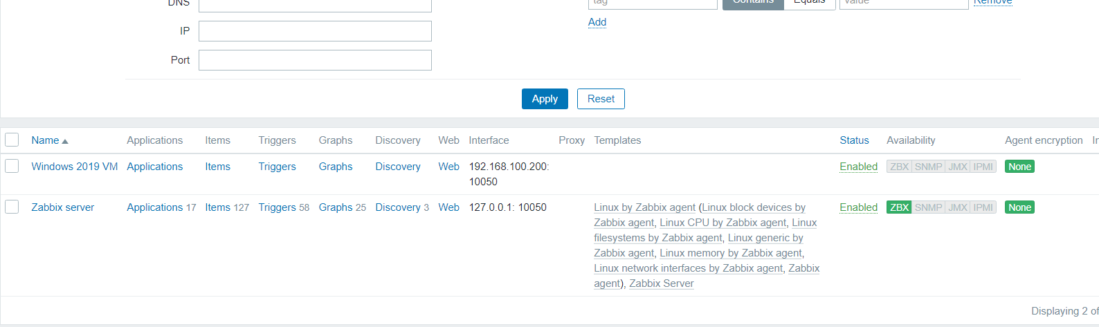

    Hi everyone, I'm new to Zabbix and have a simple problem.
    I successfully setup Zabbix server in ubuntu server but the windows agent (not agent 2) cannot communicate to my Zabbix server.
    Both firewall are off, able to ping to each other. I tried my best to research online, spent few days time but I still not able to trace the real issue, end up I came to forum seek for help. I really hope someone could help me out .

    This is my windows server zabbix conf
    Server=192.168.100.106
    ServerActive=192.168.100.106
    Hostname=DS_SVR_VM
    This is my windows server zabbix log
    5144:20210125:011752.666 Zabbix Agent stopped. Zabbix 5.2.3 (revision ae46273eae).
    2308:20210125:011752.997 Starting Zabbix Agent [DS_SVR_VM]. Zabbix 5.2.3 (revision ae46273eae).
    2308:20210125:011753.000 **** Enabled features ****
    2308:20210125:011753.004 IPv6 support: YES
    2308:20210125:011753.006 TLS support: NO
    2308:20210125:011753.009 **************************
    2308:20210125:011753.011 using configuration file: C:\Users\Administrator\Desktop\New folder\conf\zabbix_agentd.conf
    2308:20210125:011753.645 agent #0 started [main process]
    3508:20210125:011753.647 agent #1 started [collector]
    1744:20210125:011753.648 agent #2 started[listener #1]
    6132:20210125:011753.649 agent #3 started[listener #2]
    5692:20210125:011753.649 agent #4 started[listener #3]
    5788:20210125:011753.650 agent #5 started [active checks #1]
    I tried both installation method, one is windows agent msi (not agent 2), another one is CLI, both not work.

    You do not have any template with items attached to the server, and there are no items at all! Please read the documentation.
    • ultratech
      • Jan 2021
      • 10
      haha sorry this is my stupid big mistake , appreciate your reply & answer @Harmardaban
