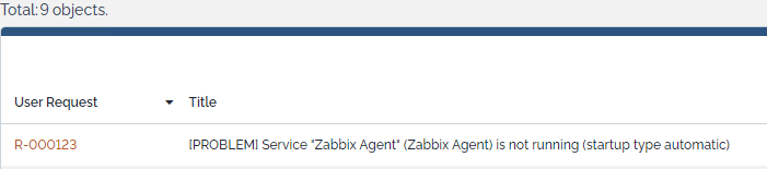

        after these modifications the errors are solved and the ticket is created correctly
Name:	2022-06-27 16_49_47-Zabbix Appliance_ Dashboard.png
Name:	ticket created.png

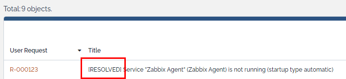

        when the status resolves, it updates itop as well.
