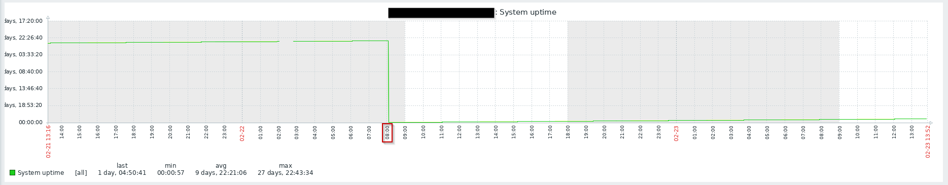

    • In the history graph of system uptime, I can see that the system in question, the one I am getting an alert for got restarted at 8.06AM I am quite sure this is reporting the right time in the right time zone because the end of the graph in "real-team" say, it's showing me the right time... now...

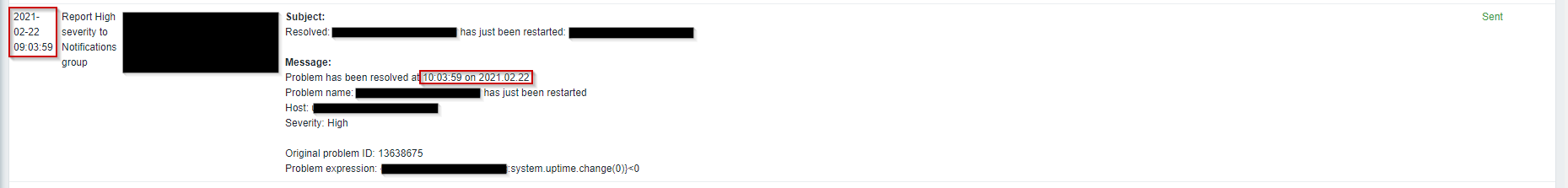

    • action log however is showing me a different time for the timestamp of the event (actual time +1h), and furthermore, the message uses the {EVENT.TIME} macro which is also showing a different time (actual time +2h)
      Click image for larger version  Name:	image2.png Views:	0 Size:	23.1 KB ID:	419311
