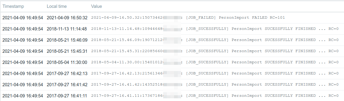

    In my configuration there was first another issue with the recovery notification - so that wasn't sent in any case. I got the second notification and thought it was the recovery message, but in reality it was a multiple event occurrence what caused the second message. After repairing that I got multiple PROBLEM and RESOLVED messages each time I added a line to the logfile.
    After really a lot of additional tests with different notification types, changing notification from "notify all" to "Send Message", reducing number of lines per second to 5 and 3 etc etc etc - I must come to the conclusion, that logfile monitoring is always sending/reporting too many lines to the server. I already thought it always runs through the whole file but finally cannot even confirm that.
    Fact is, that via the item there are always many lines reported. I add 4 Lines to a log and in the history of latest data I can see A LOT more. From the documentation it should only look at the new lines - I mean, yeah, that was the reason for using that log[...] item.

                    And I made another test. From my experience it depends on how long there was no change in the keywords from the regular expressions. If for a long while there was only success, I only get one problem notification. Not, if problem and success were alternating multiple times. See example:
