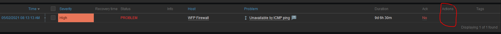

      Yes, Cyber, that's exactly correct. The action column is empty, here's the screenshot

        Yes, you are correct, good catch, problem was created earlier then I started configuring actions. To me personally it should not matter what goes first, problem or action. We are not finding the answer to the famous question what appeared first, chicken or egg
        But if this is the logic we have to follow I'll remove the problem by removing the device and then re-add it again hoping that it will trigger the action

            • 4996
            If no action is fired, then there is no match for conditions.. I suppose you also do not see anything in problem list in "Actions" column?...
              • 4996
              Was that Problem active already before you created action? It says its been already 9 days... Topic here is just 4 days old..
              Action is executed only when trigger fires... if you add action later, it will not be executed against those already active problems...
