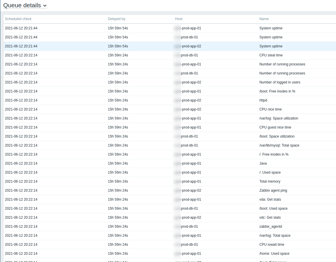

      Is it possible that it is caused by change the zabbix-agent to zabbix-agent2? Does Zabbix-agent2 needs some different configuration to make active checks to be working?
      Problems list like below:

      Queue details:

        I haven't used agent2 yet so you have to check the documentation yourself. But have you checked that the agents are running on the servers and what do their log files contain?
