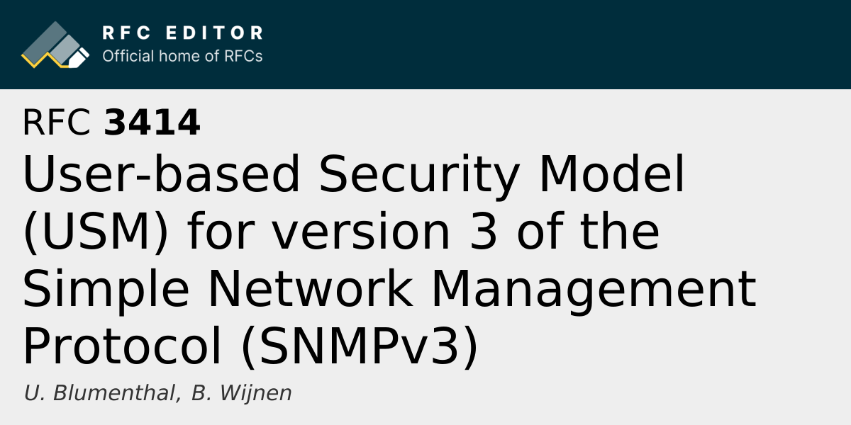

            Wow. You clearly do not understand SNMPv3.
            This document describes the User-based Security Model (USM) for Simple Network Management Protocol (SNMP) version 3 for use in the SNMP architecture. It defines the Elements of Procedure for providing SNMP message level security. This document also includes a Management Information Base (MIB) for remotely monitoring/managing the configuration parameters for this Security Model. This document obsoletes RFC 2574. [STANDARDS-TRACK]
            I'd recommend you read it and learn the difference between authentication and privacy. The auth protocol is MD5 or SHA, that is used for authentication. The data coming back, if encrypted, is the privacy protocol, which is either DES or AES. AES was added to SNMPv3 for data encryption 14 years ago: https://www.ietf.org/rfc/rfc3826.txt
