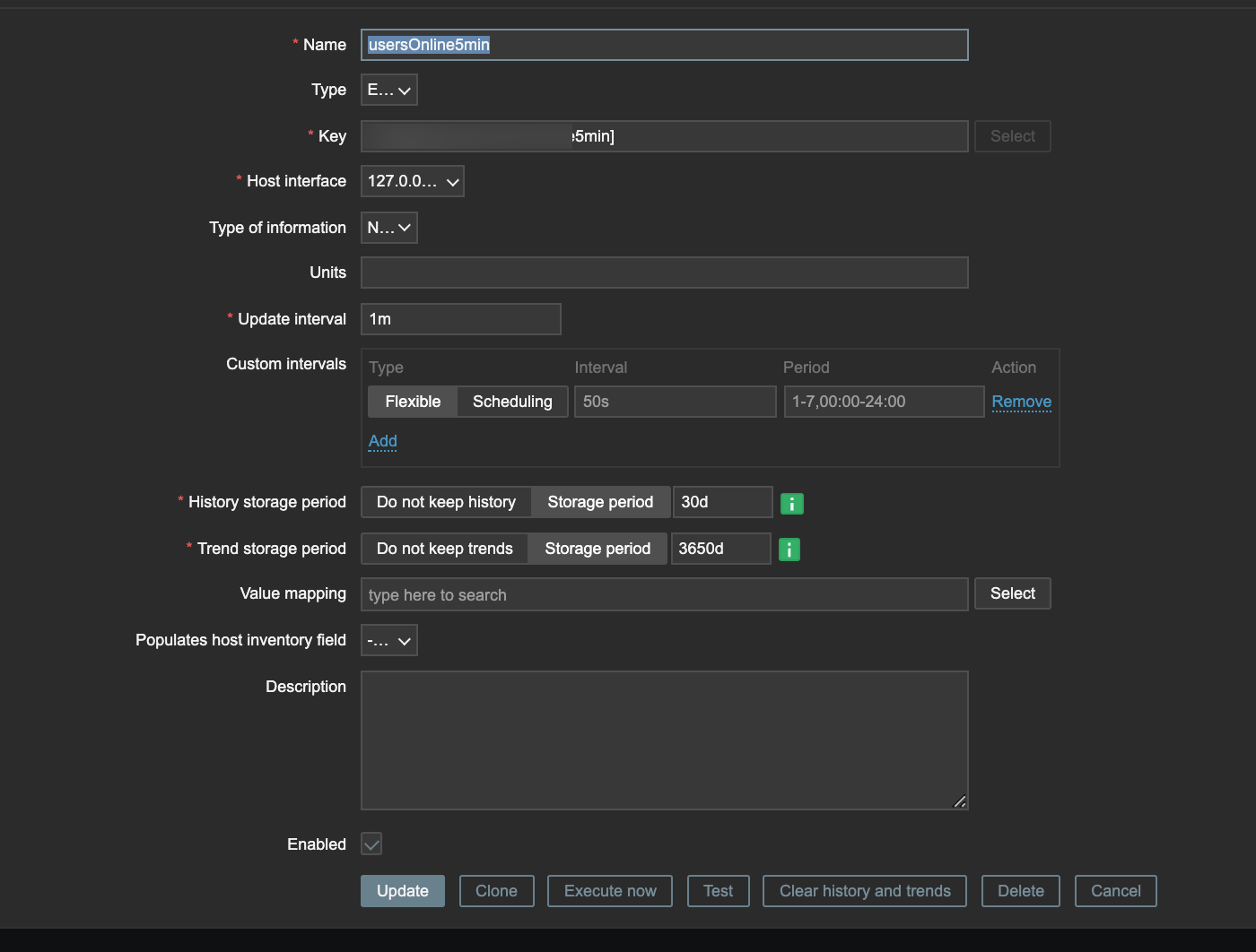

    When i enter any item i first see for small moment whole forms and then they disappear and i see only small portion of forms.
    When i try to clone some element i cannot save cloned item as many fields are gone.

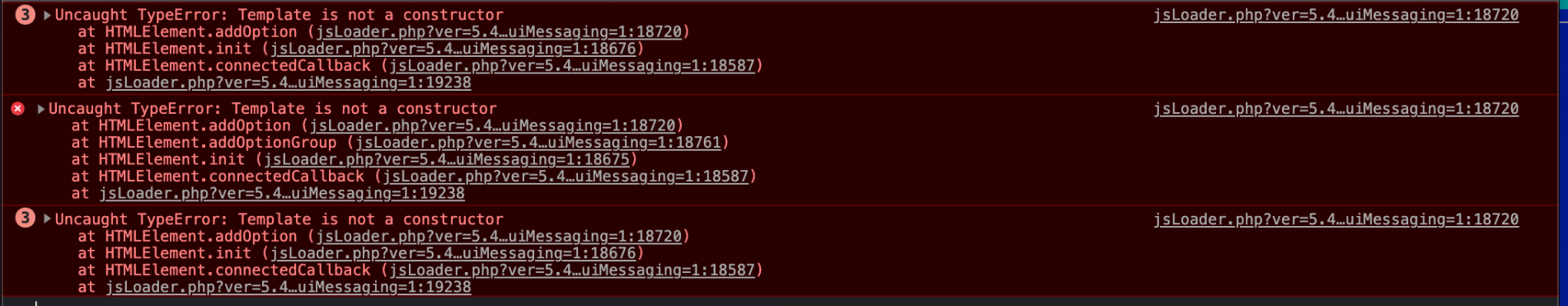

    This is what i see in browser.

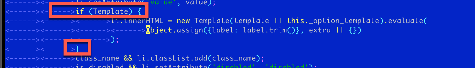

    When we added to code checking if template exists then the form appeared and i can co at least something but the form looks like that on 2nd picture below.
    This might be bug or i have broken database but no idea how to fix it.

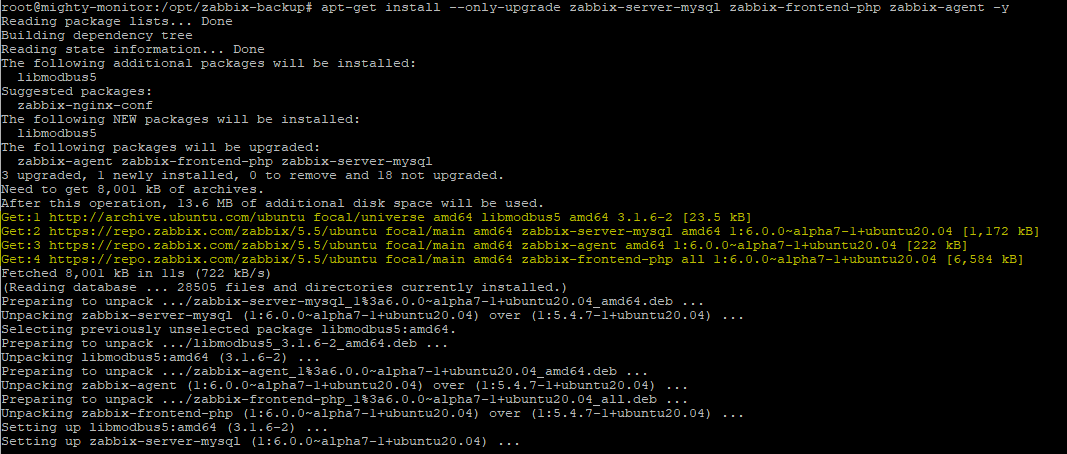

      I installed it using this official guide:
      It all worked out except this "wget" url was not found:
      I looked it up on the official download page for my ubuntu 20.04 + apache + mysql and used:
      wget https://repo.zabbix.com/zabbix/5.5/u...u20.04_all.deb
      maybe the "5.5" in the middle is the problem?

          the 5.5 is in the Link and it´s the latest available "Version" Number. I was confued too, but once I added it and upgraded the software it sais 6.0.0alpha7
