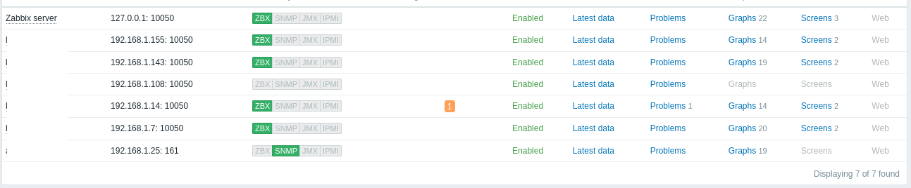

    cannot send list of active checks to "192.168.1.xxx": host [new-linux-machine] not found
    and you can see in the attached screenshot, the problem machine does not have the
    ZBX box lit up green

    First, create some item that uses Zabbix agent or link the template. If the item does not exist, the ZBX icon will not turn green.

              i used some zabbix-get commands from the zabbix appliance to the client that doesnt work..
              all calls work..
              its very odd.. so this indicates that the appliance has no problem getting info from the client.
              as you can see here.. i test 2 machines on my network.. one is communicating with the zabbix server fine and the other is the one that wont.
              [root@appliance zabbix]# for l in 192.168.1.7 192.168.1.108;do zabbix_get -s $l -p 10050 -k system.sw.os; done
              Linux version 5.4.0-100-generic (buildd@lcy02-amd64-002) (gcc version 9.3.0 (Ubuntu 9.3.0-17ubuntu1~20.04)) #113-Ubuntu SMP Thu Feb 3 18:43:29 UTC 2022
              yet it wont register in the UI
                • kstone
                  • Jul 2020
                  • 10
                  Awesome !!!
                  thats what it was... i didnt have the template in there.
                  thanks again
