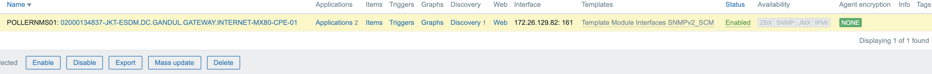

    Dear Master,
    I have problem with monitoring host for router MX80 in zabbix, the router use Template Module Interfaces SNMPv2_SCM but if i see on host menu Availability snmp not green and red.
    The monitoring is using snmp agent, herewith the topology : device -> zabbix proxy -> zabbix server.

        • 4996
        That pic shows, that host has no items. So no polling is taking place. Thus, icon cannot turn green...
        You seem to have one discovery there. I only guess, that it should create those items. Maybe you should verify, if that is working properly.

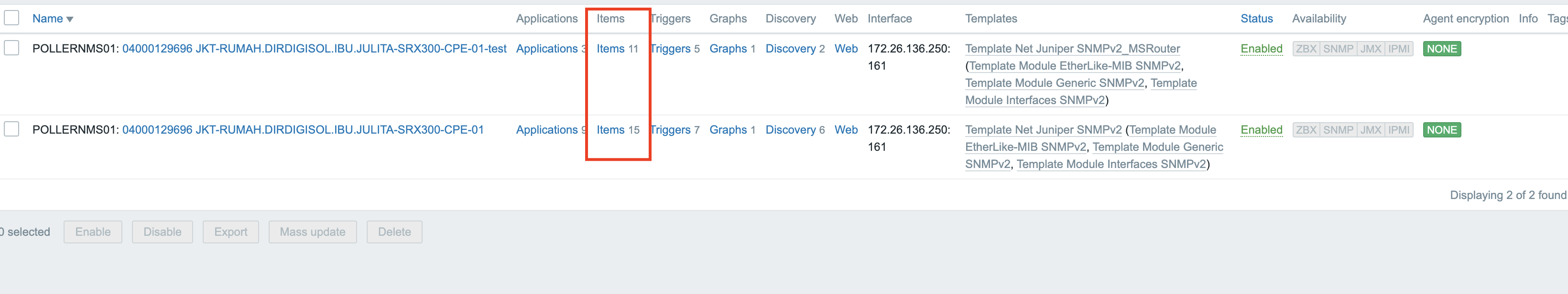

            Cyber,
            This is same issue, hostname have items, but snmp not green.
            Could you please your advice ? what should i do? please check attachment
            Thank You
              • 4996
              Are any of those items returning any data? If not, then that availability icon situation is understandable .If you get data back, then I have no idea, why it is not turning green..

                Cyber,
                You are correct and i think, i know the root cause is the template not proper for this host so item can not returning any data.
                If i run snmpwalk and query one of item key , example icmpping. There is no data found.
                Do you know where is i can get the proper template for device Juniper SRX-300 ?
                [root@xxx mzi]# snmpwalk -v 2c -c @MS-ICON+ 172.26.136.250 | grep -i icmpping
                [root@xxx mzi]#
                Really appreciated for any help.
                Thank you
                  • 4996
                  I can only point you to official templates https://git.zabbix.com/projects/ZBX/...t/juniper_snmp It is not specific to your device, but should gather basic data for any juniper devices, I assume.
                  icmpping is not really a snmp item. Doing "fping <device>" from command line is the same. But ping success does not turn SNMP icon green as it is not SNMP ...
