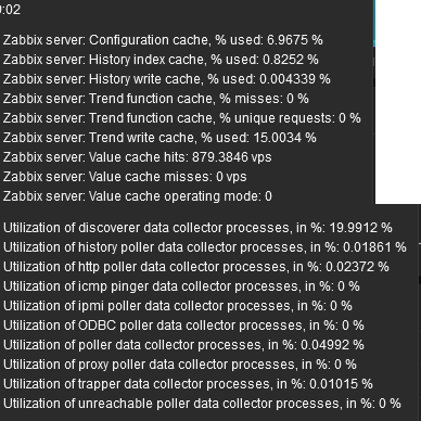

          no DB partitionsing. Default housekeeper settings.
          no one metric above 20% at any time.
          https://www.zabbix.com/forum/core/im...AASUVORK5CYII=
          https://www.zabbix.com/forum/core/im...AAAElFTkSuQmCC
