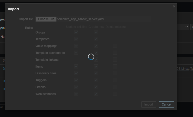

      importing taking forever.
      • piti
        piti commented
        same problem... cannot import template to 6.0
    • highpeak
      • Nov 2019
      • 30
      Upgraded to 6.0.2 and same issue here, template import fails to complete.
      • MarGeta
        • Nov 2021
        Same here, can no longer import templates
        • guillermo.los
          • Jun 2021
          What I had to do to import the template is increase the PHP memory way over the recommended value and then works.
          then I put back.
          • eDonkey
            eDonkey commented
            Solved it for me too.
        • eDonkey
          • Jun 2022
          If the import is stuck uploading, do as guillermo.los said.
          Just increase the php memory (on Ubuntu located in "/etc/zabbix/apache.conf").
          For me setting "memory_limit" to 800M was enough to do the upload.
