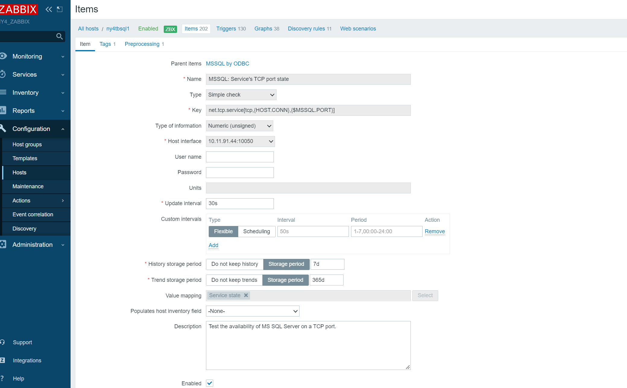

    I am trying to add MSSQL template and getting error MSSQL: Service is unavailable. Checking deeper - this error caused by simple check net.tcp.service[tcp,{HOST.CONN},{$MSSQL.PORT}] where the port is specified by macro as 1433
    Next step was to create simple check standalone in gui and test. It indeed does not work (returns 0). I also run tcpdump and do not see any packets sent.

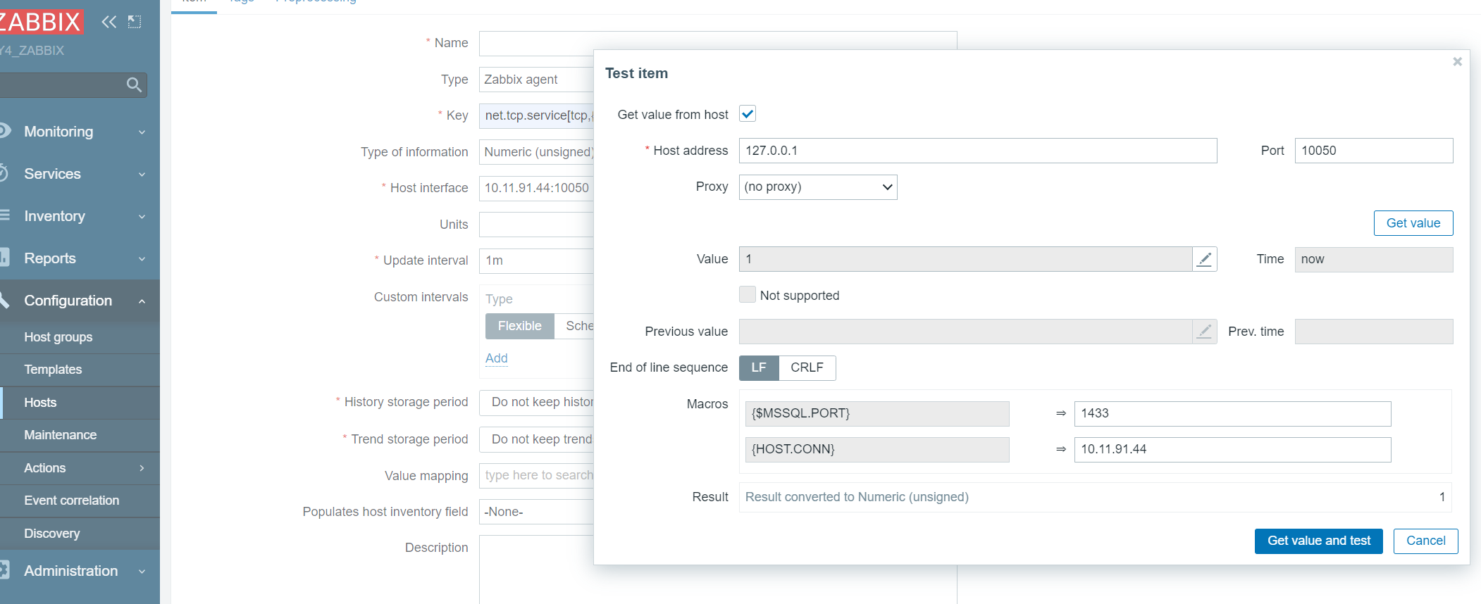

      yes, when I configure it as Zabbix agent it works for all ports. For test I gave the IP address of the Zabbix server as an agent (127.0.0.1). Click image for larger version

      But this does not solve my problem as for MSSQL the pre-defined trigger uses "simple check" and not Zabbix agent - therefore it reports the port is not active.
      This is the configuration of the MSSQL trigger in Zabbix:
      As you can see, it is set as Simple check.
      Therefore, it seems there is a defect as Simple check is implemented unless there is some secret configuration to unblock ports.
