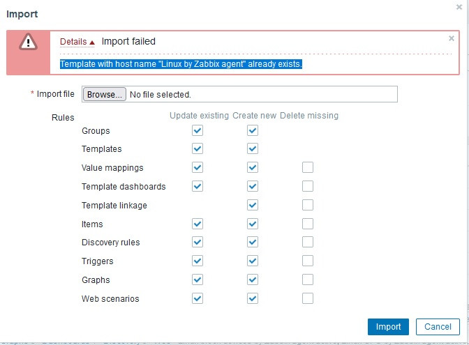

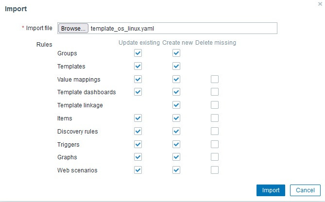

    After updating my zabbix installation to 6.0.5, I'm trying to update the templates to the appropriate 6.0 versions, but all of the imports are failing.
    For example, I'm importing "https://git.zabbix.com/projects/ZBX/repos/zabbix/browse/templates/os/linux/template_os_linux.yaml?at=refs%2Fheads%2Frelease%2 F6.0"
    I have all of the "create" and "update" options selected:

    when I hit import, I see the diff between the existing and the new, but then I get:
    "Import Failed: Template with host name "Linux by Zabbix agent" already exists."

      On the diff page, it appears to be matching the change to a "Template OS Linux by Zabbix agent" template, rather than the "Linux by Zabbix agent" template. Having both appears to be a carry over from upgrading from zabbix 4.x to zabbix 5.x when that import did not replace the older template.
      I wonder if its trying to replace the older template "Template OS..." and then failing as "Linux by..." already exists.
