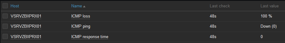

    I have some freshly installed proxies connected to a fresh server installation. The template ICMP Ping is detecting all of them (and all the other host directly monitored by the server) as down.
Name:	zabbix status.png

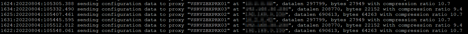

    The ping template itself seems to be working fine too, as all the hosts monitored by the proxies get successfully pinged by the template. It seems to be a problem related to the main zabbix server only. In the logs of the zabbix server there is no error, only the data transmission between the server and the proxies:
