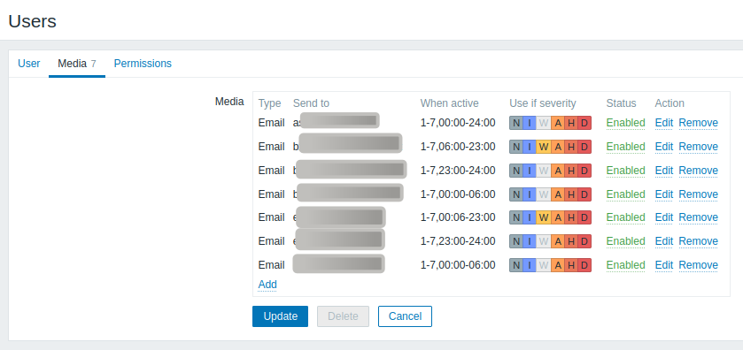

    I have the following config for notifications. I have some triggers whose severity is Warning.
Name:	Captura desde 2022-11-03 09-21-27.png
    Even with this config, I do still receive notifications of triggers whose severity is warning for instance from 00:00 to 06:00 when by what I understand I shouldn't.

    Based on media configuration I could see you've enabled alerts for warning severities for 2 users. For which you'll receive alerts.

        Are you receiving alerts for both users or only 1. Because for 1 user start time window is wrongly mentioned as 00:06 while it should have been 06:00.
      • 4996
      2 users with warnings...
      one active from 06:00-23:00, other from 00:06-23:00 I suppose you are the second one?
      • superlava
        superlava commented
        I am suspecting 00:06 is the issue.

      • superlava
        superlava commented
        It's not the issue with time format.
        For the second user, time should be 06:00-23:00 not 00:06-23:00

      Thank you so much!!!!
      I wasn't able to understand this!! I pasted the alerts times just for you to have an idea of what I was trying to do... but there was the problem!!!!
