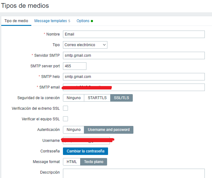

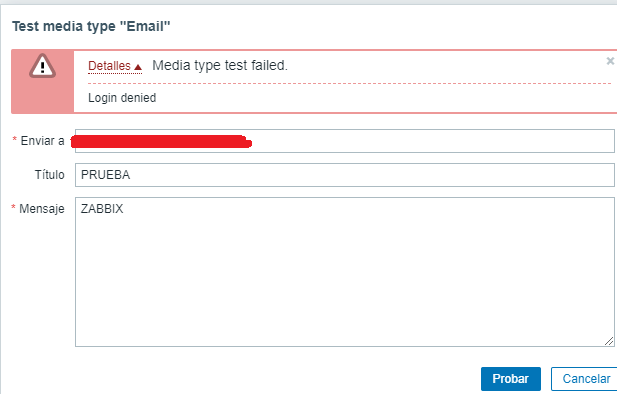

    I did all the configurations to put an alert email but when trying to send a test didn´t work and here are the mistakes:
    When I introduce username and password
    Media test failed
    Login denied

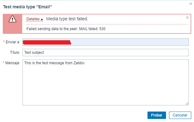

    When I don´t put username and password in Media Type:
    Test media type "Email"
    Media test failed
    Failed sending data to the peer: MAIL failed: 530

    login denied explained it cant login to gmail.
    u need to turn off the two step verification from gmail's setting
    open gmail go to ur account > manage your google account > security >> Signing in to Google (app password) create a password for ur zabbix server ....
    use this password for login .
    • adrian.sayers473
      adrian.sayers473 commented
      This was very helpful and it worked, thank you. the location changed slightly. it still is in security but under 2-factor authentication.

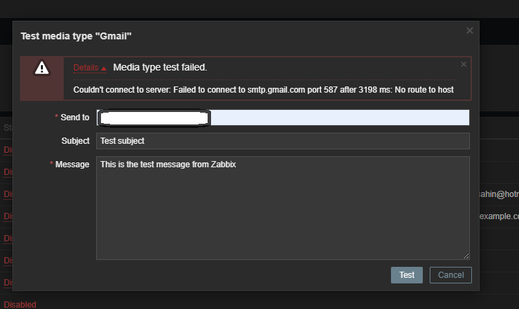

    Hi everyone,
    I'm having a similar problem. The error is as follows. I use GMAIL as media type. the server accesses the internet.
    note:
    On the Gmail side, I enabled access to less secure applications. Additionally, MFA is active on the Gmail side.
    The application password was defined by Gmail and entered into Zabbix.
