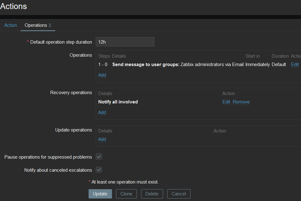

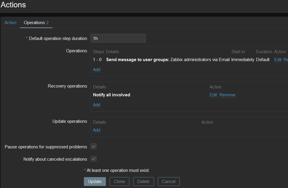

    Hello Together,
    I would like to set the notification repetition to 12 hours. So that we are reminded of a critical problem by mail every 12 hours until the problem is solved.
    Unfortunately, Zabbix won't let me change the value here. As soon as I leave the tab and click on it again, it returns to 1 hour.

    Does anyone have an idea what this could be or how I can change this value?
    Many thanks in advance for your help.

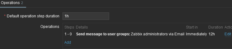

    • FrM222
      • Aug 2022
      • 48
      Here, unfortunately the value also falls out again as soon as I go to another tab.

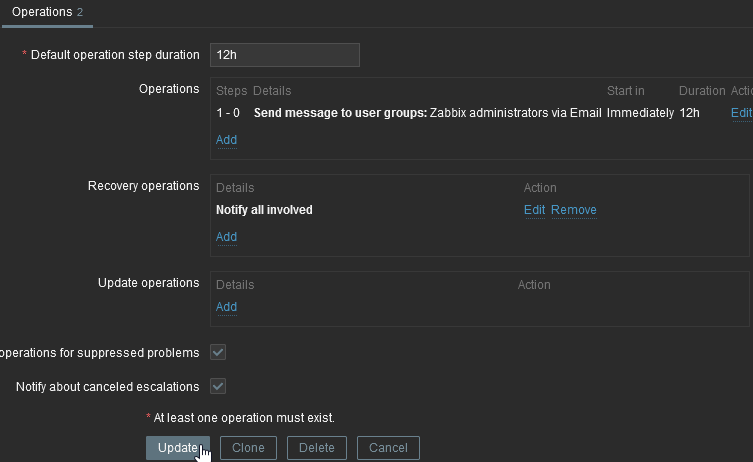

        • FrM222
          • Aug 2022
          • 48
          Ah, if I don't change the default value, it works.
          This setting now means that a problem is reported immediately after the first occurrence and then it is only reminded again after 12 hours, right?
