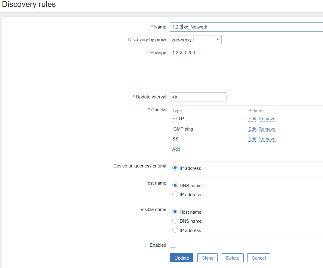

    What kind of checks you have configured? I mean these: Click image for larger version

    • ElementZero
      • Jan 2021
      • 16
      See below

        Your discovery rule creates the host name as DNS name, and the agent is using its agent name.
        Change the discovery rule to set host name to the agent name.
        See also https://support.zabbix.com/browse/ZBX-22137. What is your Zabbix version?

          Using Version Zabbix 6.2.2. I changed it to Host name: Zabbix agent "agent.host" but that didn't seem to resolve the issue. Not sure if there is a log I could see of why its not finding it? All I see in the log on the client is
