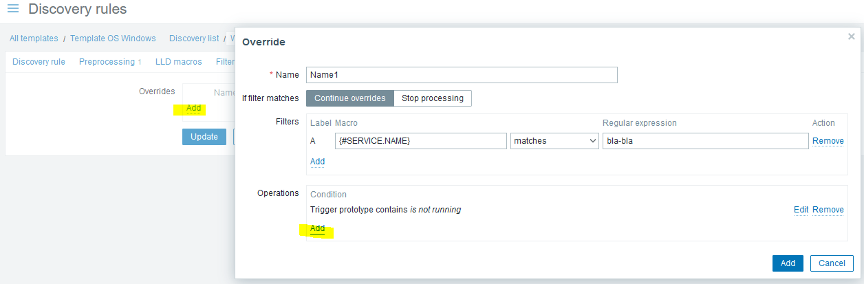

      • Hamardaban
        • May 2019
        • 2714

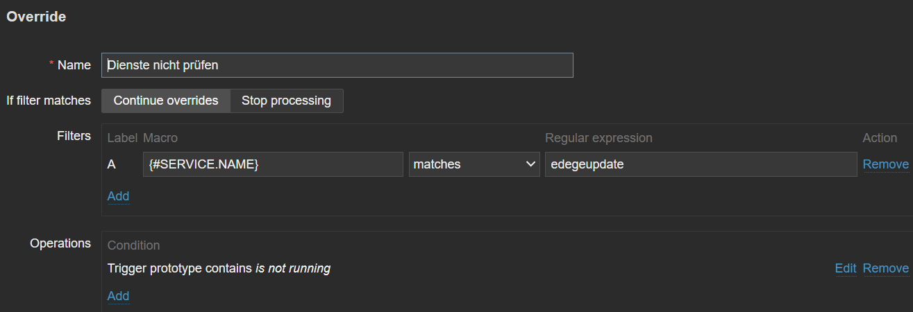

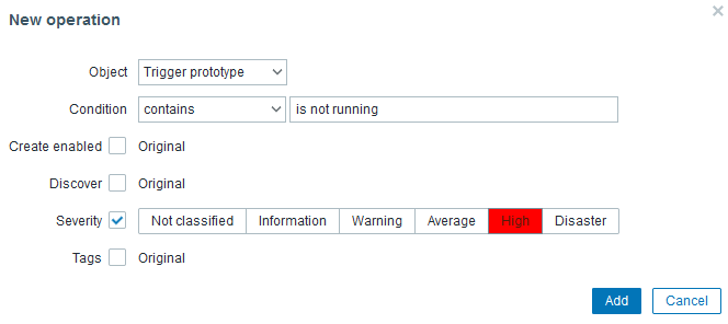

        In the discovery rule at the "Override" section, you define a condition for changing the importance of a particular trigger.
        For example, if the {#SERVICE.NAME} is "bla-bla" , then change the importance of the trigger to "High".
        Details are in the documentation.​

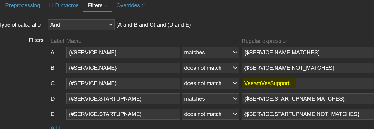

            Another option is used for exclusion - "Filter"

                  I have now tried both ways. Once with "override":

                  And once the exclusion with "filter":
                  Have I done something wrong here? I still get the warning messages every day.​
