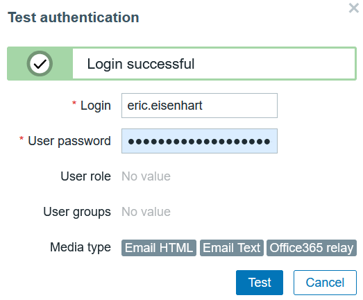

    This is a new zabbix 6.4 installation that I'm trying to set up LDAP authentication against AD servers on with the new JIT. Everything else works, but it isn't able to map group info and I can't figure out why or even where to look to get more details.
    Any hints on places to get additional debugging out of this are welcome.

    But test authentication doesn't map group:

              Aftern reading further i found the solution:
              Using memberOf and leaving the "Group Name Attribute" empty did the job.
              Tested nested groups: does not work, only direkt membership of the users.
