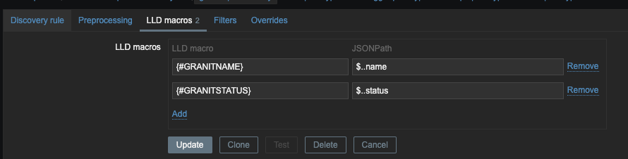

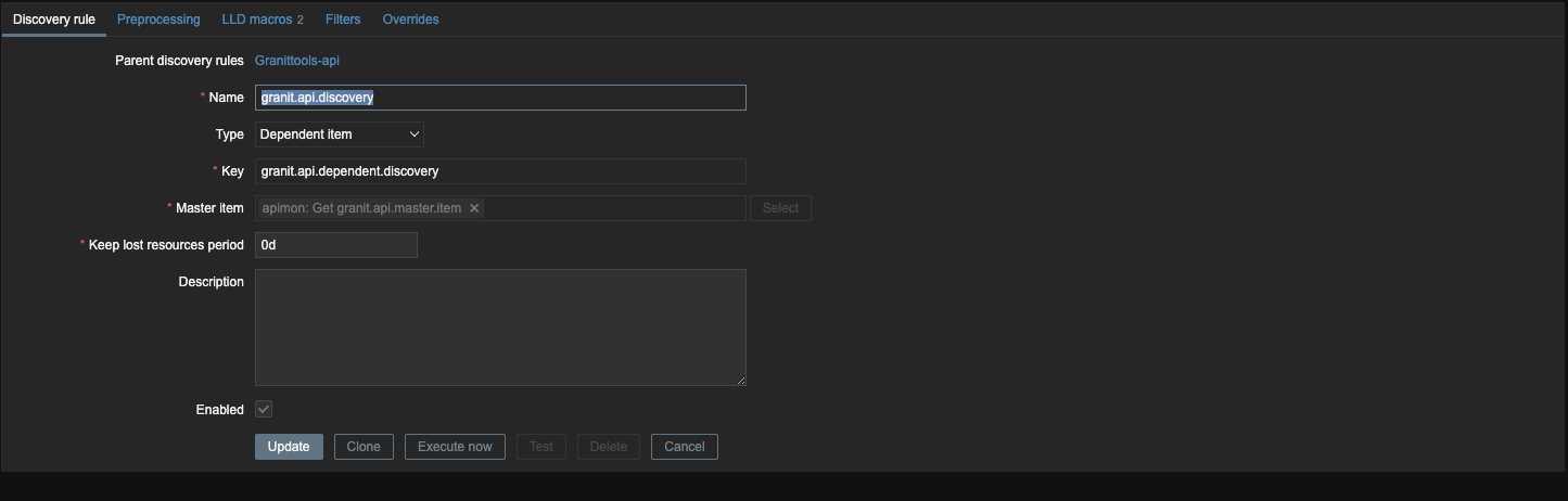

    ​2. I created a discovery rule (granit.api.dependent.discovery) as a dependent item on the http agent master item (granit.api.master.item) and i created a LLD macro
    Macro:

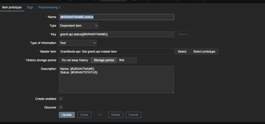

    a) I created a test item prototype

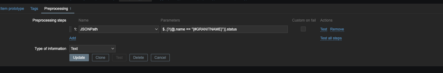

    b) a preprocessing step

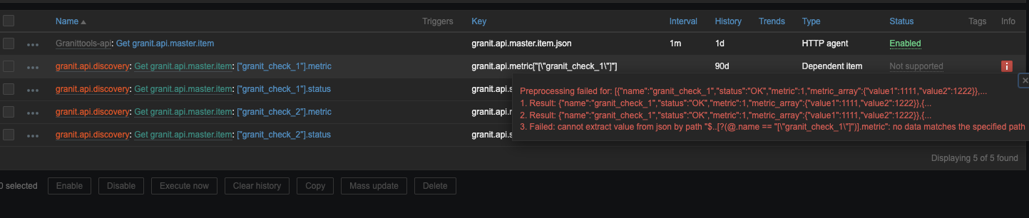

    Now the problem:
    It keeps the bracket and the double quotes and therefore JSONPath is not finding the .status in the json. see the screenshot below
    How can i prevent the brackets und quotes from being used by zabbix ?
    What am i doing wrong?
    Incorrect item prototype:
    ["granit_check_1"].status
    Desired item_prototype:
    granit_check_1.status
    granit_check_1.metric

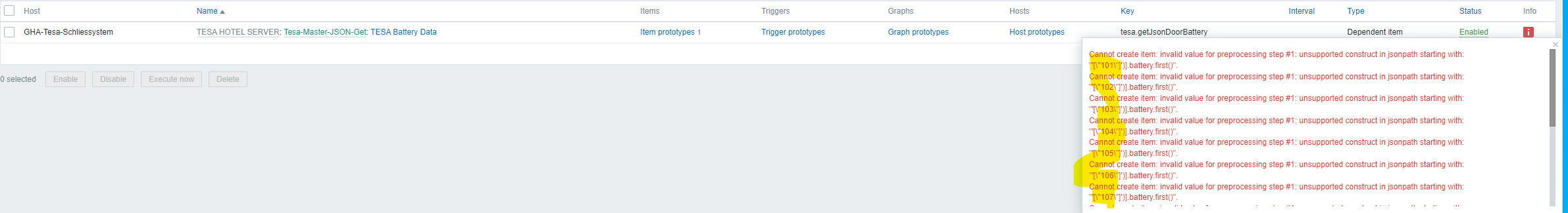

    Zabbix Version: 6.4
    currently we are struggling with the same issue. Failing at the item prototype step. {#MACRO} is escaped.
    we have a script that queries hotel room door battery states and sends them via zabbix_send as a payload to zabbix.
    I'm by far no expert on this field, but any help would be appreciated.
    Doc:
    Is there a way to change the outcome on item prototype preprocessing?
    Payload:
    Schliessystem tesa.getAllDoorBattery [ {"door":"101","battery":40}, {"door":"102","battery":60}, {"door":"103","battery":40}, {"door":"104","battery":40}, {"door":"105","battery":60}, {"door":"106","battery":40}, {"door":"107","battery":60}, {"door":"108","battery":60}, {"door":"109","battery":60}, {"door":
    "110","battery":40}, {"door":"111","battery":40}, {"door":"112","battery":60}, {"door":"113","battery":40}, {"door":"114","battery":60}, {"door":"115","battery":40}, {"door":"116","battery":60}, {"door":"117","battery":60}, {"door":"118","battery":40}, {"door":"119","battery":60}, {"door":"120","battery":60}, {"door
    ":"121","battery":60}, {"door":"122","battery":60}, {"door":"123","battery":40}, {"door":"124","battery":40}, {"door":"125","battery":40}, {"door":"126","battery":40}, {"door":"127","battery":40}, {"door":"128","battery":60}, {"door":"129","battery":60}, {"door":"130","battery":40}, {"door":"131","battery":60}, {"do
    or":"132","battery":60}, {"door":"133","battery":40}, {"door":"134","battery":60}, {"door":"135","battery":60}, {"door":"136","battery":40}, {"door":"2-Netzwerktechnik","battery":60}, {"door":"201","battery":60}, {"door":"202","battery":40}, {"door":"203","battery":60}, {"door":"204","battery":60}, {"door":"205","ba
    ttery":20}, {"door":"206","battery":40}, {"door":"207","battery":40}, {"door":"208","battery":60}, {"door":"209","battery":40}, {"door":"210","battery":40}, {"door":"211","battery":40}, {"door":"212","battery":60}, {"door":"213","battery":60}, {"door":"214","battery":40}, {"door":"215","battery":60}, {"door":"216","
    battery":60}, {"door":"217","battery":60}, {"door":"218","battery":40}, {"door":"219","battery":40}, {"door":"220","battery":60}, {"door":"221","battery":60}, {"door":"222","battery":40}, {"door":"223","battery":60}, {"door":"224","battery":40}, {"door":"225","battery":40}, {"door":"226","battery":40}, {"door":"227"
    ,"battery":60}, {"door":"228","battery":60}, {"door":"229","battery":60}, {"door":"230","battery":40}, {"door":"231","battery":60}, {"door":"232","battery":60}, {"door":"233","battery":60}, {"door":"234","battery":60}, {"door":"235","battery":60}, {"door":"236","battery":60}, {"door":"237","battery":60}, {"door":"30
    1","battery":80}, {"door":"302","battery":60}, {"door":"303","battery":60}, {"door":"304","battery":40}, {"door":"305","battery":40}, {"door":"306","battery":40}, {"door":"307","battery":60}, {"door":"308","battery":80}, {"door":"309","battery":60}, {"door":"310","battery":60}, {"door":"311","battery":60}, {"door":"
    312","battery":60}, {"door":"313","battery":60}, {"door":"314","battery":40}, {"door":"315","battery":60}, {"door":"316","battery":60}, {"door":"317","battery":60}, {"door":"318","battery":60}, {"door":"319","battery":60}, {"door":"320","battery":90}, {"door":"321","battery":60}, {"door":"322","battery":60}, {"door"
    :"323","battery":90}, {"door":"324","battery":60}, {"door":"325","battery":60}, {"door":"326","battery":60}, {"door":"401","battery":60}, {"door":"AR.B1.1","battery":60}, {"door":"AR.B1.2","battery":60}, {"door":"AR.B1.3","battery":60}, {"door":"AR.B2.1","battery":60}, {"door":"AR.B2.2","battery":40}, {"door":"AR.B2
    .3","battery":80}, {"door":"AR.B2.4","battery":90}, {"door":"AR.B3.1","battery":60}, {"door":"AZ.EG","battery":100}, {"door":"AZ.KG","battery":100}, {"door":"AZ.OG1","battery":100}, {"door":"AZ.OG2","battery":100}, {"door":"AZ.OG3","battery":100}, {"door":"Haupteingang","battery":100}, {"door":"2","battery":90}, {"d
    oor":"Haupteingang_ALT","battery":60}, {"door":"K.A1.1","battery":60}, {"door":"K.A2.1","battery":40}, {"door":"K.A3.1","battery":60}, {"door":"K.B3.1","battery":100}, {"door":"L.B.3.1","battery":100}, {"door":"WL-GAR-EINFAHRT","battery":60}, {"door":"WL-GAR-UNTEN","battery":100}, {"door":"WR.B3.1","battery":100}, {
    "door":"test","battery":100}]
    key getAllDoorBattery is in the parent item.
    Item Prototype:
    Stuck at this point:
    ​​Click image for larger version

      DrMoe
      Try changing your LLD Macros to $..name.first() and $..status.first()
      maybe it helps.
