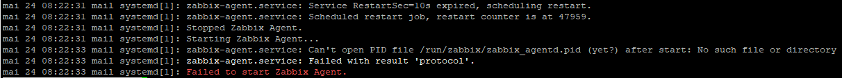

    So I looked at the logs of my agent and I have this message
    "Zabbix-agent.service: can't open PID file /run/zabbix/zabbix_agentd.pid (yet?) after start: no such file or directory
    zabbix-agent.service: Failed with result 'protocol'
    failed to start zabbix agent"

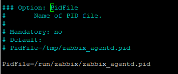

        When i check in the file /etc/zabbix/zabbix_agentd.conf, i do have a line with PID
        Should i create this file with nothing in it ? (Zabbix will then find it and complete it ?)
        I probably dont have this file because of my error with DPKG.
        Hope i answered your question, feel free to ask for more information and i'll do my best to provide.

                  Here is the output from the zabbix agent file
Name:	Capture d'écran 2023-05-24 082342.png
