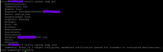

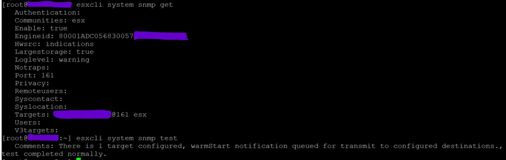

    Hi everyone.
    I have configured a Zabbix server with the latest version and connected a lot of hosts with both agent and SNMP methods: they are working fine.
    These are the steps i have done:
    - configured the community on esxcli with the name 'esx'
    - configured the target to the Zabbix server
    - restartd the snmpd agent server
    - configured the host on Zabbbix server with the same community
    but the Zabbix server not communicate with Esxi: the SNMP icon remain in grey color.
    I attach the status of the SNMP agent on ESXI server.
    What i can check on the Zabbix server?
    Thanks.

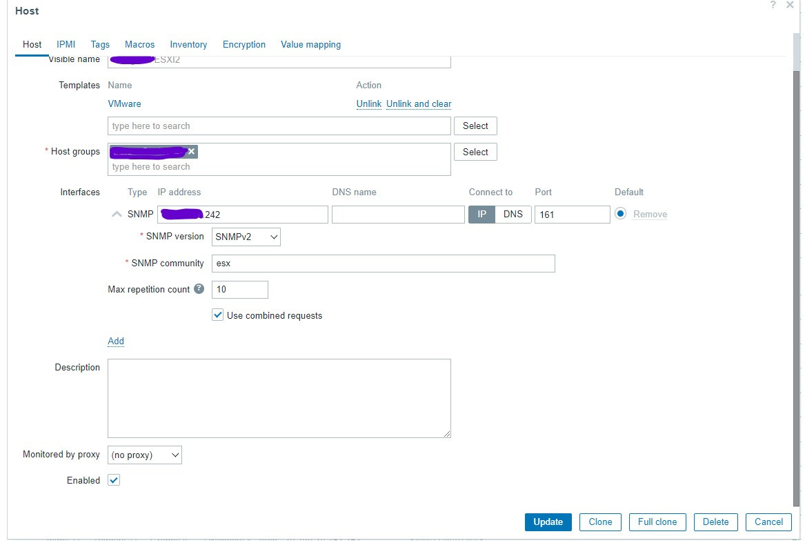

    • Maybesrl
      Maybesrl commented
      The template applied is Vmware, as shown in attach.
      If i di Monitoring/Host Ping Script it respond correctly.
  • Maybesrl
    • May 2023
    The attach
Name:	Screenshot 2023-05-31 092044.jpg
      • 4996
      Template name can be "vmware", but what kind of items you have in there?
      • Maybesrl
        Maybesrl commented
        It is the default template.
        Effectively there are only 3 Items and no Triggers
      • 4996
      This one? https://www.zabbix.com/integrations/vmware#vmware
      /facepalm...
      If you notice, there is not a single SNMP item...
      • Maybesrl
        Maybesrl commented
        I see, but....
        I tried these steps
        - First i used a "Linux by SNMP" template, and the SNMP icon become green, becouse some general information was read from Esx host: so the communication with the SNMP community is working fine
        - Then i used "VMware Guest" template: in the documentation is specified that is used 3 macros {$VMWARE.PASSWORD}, {$VMWARE.URL}, {$VMWARE.USERNAME}
        I insert the appropriate value in the the Inerithed and Host Macros tab (is requested also a {$SNMP_COMMUNITY}) but in that case the communication not work: icon gray and error in the Monitoring / Latest Data Collection.
        Why?
      • 4996
      Why, you ask?
      Because you don't care to read docs... https://www.zabbix.com/documentation.../vm_monitoring.
      And please, answer with a post, not with a comment (I don't understand, why they keep the feature at all). Otherwise it is not possible to properly quote or answer to you ..
