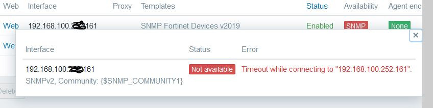

      But I am Now facing problem ro connect to my fortygate firewall
      iattached pic
      but from my zabbix server if i do a snmp walk its fine
      would highly appreciate your advice and help .. Is there we can find as to whats blocking in the firewall
      thanks and Regards
      simon
        • 4996
        Does that {$SNMP_COMMUNITY1} have a value?
        I am not familiar with this template, so I cannot really help much here.. Just verify, if all the needed macros have values etc..
        • sbdcunha
          • May 2023
          • 27
          Dear cyber,
          thanks for the immediate reply
          u r right no macros have value and under inherited macros no macros can be seen,
          if you can advise me the right template to import for forty gate i really appreciate
          Thanks and regards
          simon
            • 4996
            I don't know anything about fortigate stuff. But you should probably give values to those macros and you may get your results... Just like if you define community on command line, you need to define those for your templates/hosts also, otherwise it will not work.
