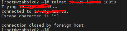

      The communication is enabled in both directions.
      This is the result from the server I want to monitor to the Zabbix server
      And the result from the Zabbix server to the server I want to monitor:
      The communication is enabled as well.

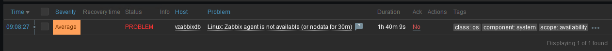

            On the web console appears this error:
            But the agent is running:
