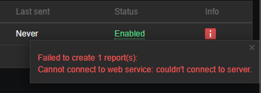

    Hi there,
    Trying to get scheduled reporting working and hoping someone can point me in the right direction!
    I've followed https://assets.zabbix.com/files/work...ith_Zabbix.pdf apart from because I'm running nginx my front end is just http://x.x.x.x not http://x.x.x.x/zabbix
    I uncommented / edited the following lines:
    zabbix_server.conf
    StartReportWriters=3
    WebServiceURL=http://localhost:10053/report
    zabbix_web_service.conf
    ListenPort=10053
    IgnoreURLCertErrors=1
    logfile=/var/log/zabbix/zabbix_web_service.log​
    My report has 'info' error beside it: 'Cannot connect to web service: couldn't connect to server'
    When i open the report and test i get 'No media configured for the report recipients'​
    The recipients do have media configured and are receiving emails from trigger actions and tests
    zabbix-web-service.service shows active (running) and tail /var/log/zabbix/zabbix_web_service.log doesnt show anything other than the service starting.
    Any ideas what to try?

          • wetchary
            • Jul 2023
            Hi Guys,
            I have this problem:
            Please can you help me, thanks.
            • trimoon
              • Jul 2023
              • 11
              Originally posted by markosa
              If it's in path then there's no need to add it. Have you tried to add server IP to allowedip list? Not localhost but whatever address is used when accessing to GUI? You could also raise debuglevel of the webservice to see detailed error messages.
              I changed:
              AllowedIP=127.0.0.1,192.168.0.22/24,::1,zabbix.wo.local
              Also have debug level set to 4 in zabbix_web_service and ran:
              only shows service starting and stopping...
              Still getting this error:
              Any ideas of other things to check?
              Thanks!
