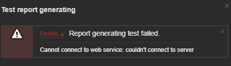

        I spoke too soon. The error is gone from the scheduled reports screen, but when i try and generate a test from within the new report, a similar error appears:
        Different error which is encouraging but still seems to be broken in a related way.

          Originally posted by vijayk
          Have you checked the logs? Web service logs and Zabbix Server logs.
          tail zabbix_web_service.log only shows starting / stopping web service. Nothing strange in there.
          tail zabbix_server.log shows some variable name errors for some MIB's. Housekeeper deleting things... Doesnt look related.
          • vijayk
            • May 2023
            • 305
            #20
            Refer the URL.
            SELinux is also causing the issue. Please verify it.
            grubby --update-kernel ALL --args selinux=0
            reboot​
              Refer the URL.
              reboot​
              That did it. Scheduled reports coming through.
              I had ran:
              sudo setenforce 0
              But not:
              Thank you VERY much for your help on this!
