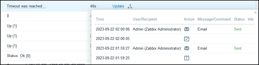

            You can check the trigger email status at Monitoring-->Problems. It will show you if mail is sent or not.

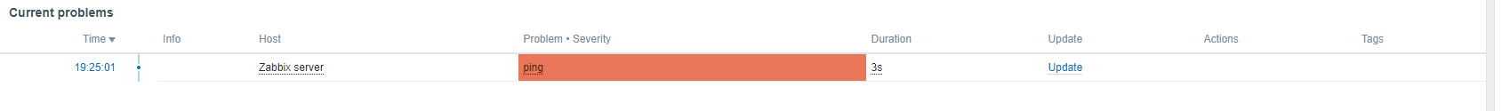

                here is problem visible at dashboard

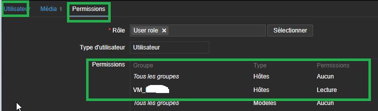

                  Sorry for my late replies,
                  thanks @vijayk
                  as well as this control,
                  the zabbix user that you use to send mail must have read rights on the host groups​

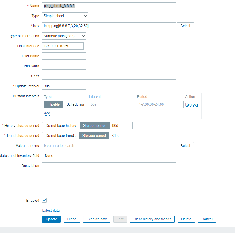

                  this is definition of item

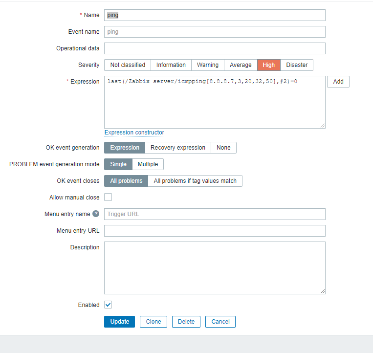

                  this is definition of trigger

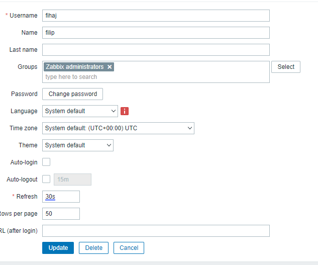

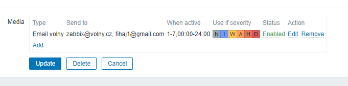

                  user definition and his email addresses

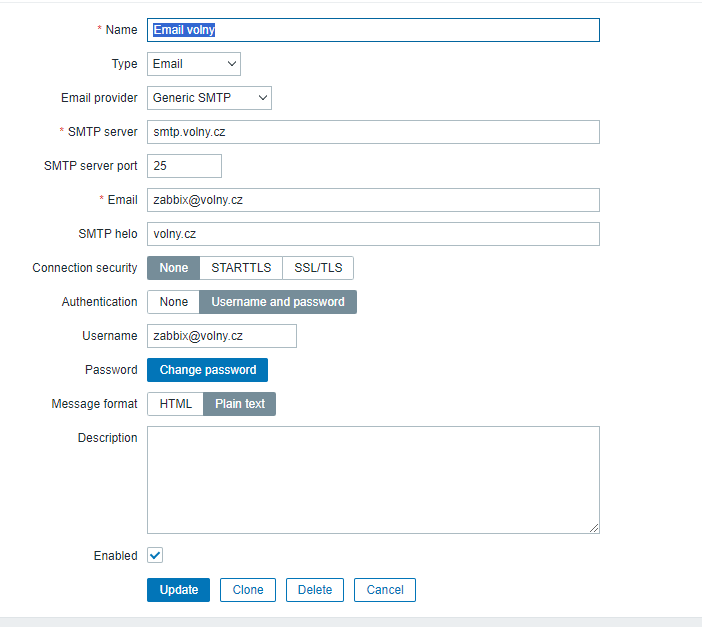

                  definition of email

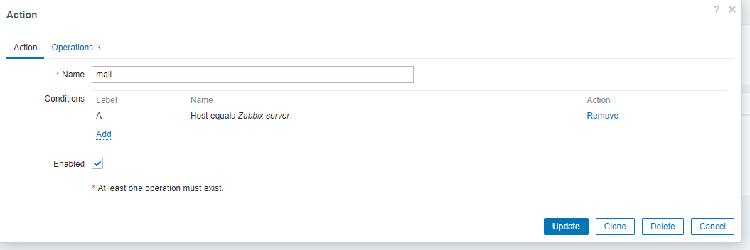

                    definition of alert action (item ping 8.8.8.8 created on zabbix host)

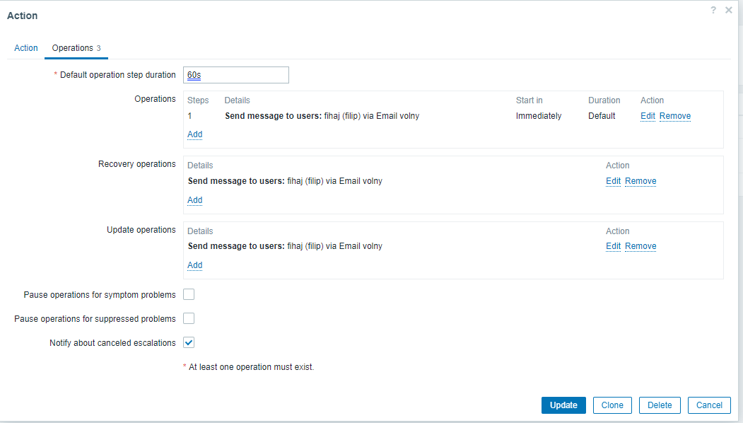

                    detail of action/operation
                    maybe there is some error in action, because trigger looks ok and problem is visible on dashboard,
                    but i did not see the error in my settings
                    thank you Filip

                      Your condition is wrong. You have to select trigger instead of Host in Action.
                        • 5004
                        No you don't... Why do you think there is an option to choose host, if it is wrong?
                        • vijayk
                          • May 2023
                          • 305
                          https://www.zabbix.com/documentation...ion/conditions
                          May be you are right. But he need only one trigger alert.
                            • 5004
                            #15
                            he may need an email for one trigger, but how to define an action here is irrelevant, is it based on trigger or based on host. Result is the same - email gets sent.
                            But I am pretty sure it is a testing scenario here, and OP will change things around when something real needs to be done.
                            I still have a feeling, there is something with user permissions here... Something too obvious, that I cannot put a finger on it..
