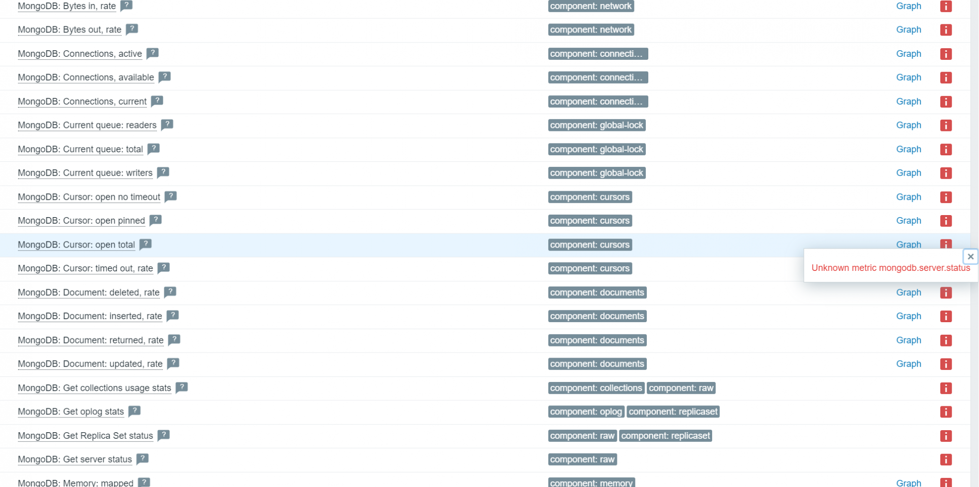

    but still it doesnt send data when i go to the latest data section, there are error on all mongodb items the error is Unknown metric mongodb.server.status without giving any data I can use to troubleshoot
    ​Click image for larger version  Name:	Screenshot 2023-09-23 085803.png Views:	0 Size:	850.5 KB ID:	471025​
