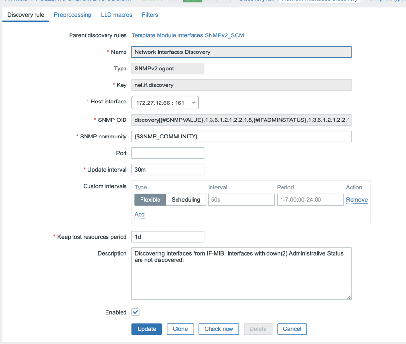

        Can you post the discovery rule here which you created?

          hello vijayk,
          Thank you for your response, here it is the discovery rules detail

          • vijayk
            • May 2023
            • 305
            Change the update interval value from 30m to less. It might be helpful.
