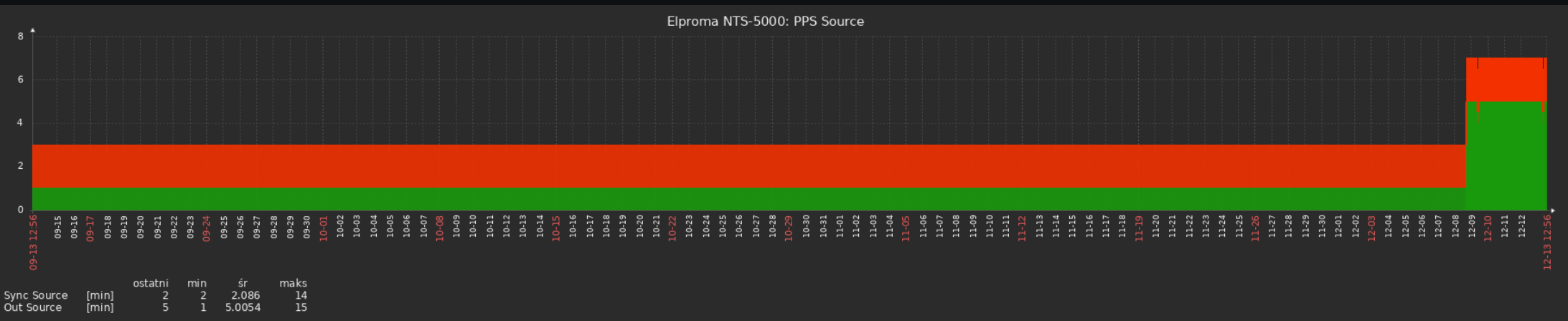

I have problem with zabbix server graphs faking past data, this data does not exist, especially because back then server did not exist (was not configured/flashed).
Server is connected and configured about 4~5 days ago (as of time of posting), graph (in attachments) was configured for period of 3 months.
I've found this (https://support.zabbix.com/browse/ZBX-15738) issue, I think it was ignored.?
I have also found this (https://www.zabbix.com/forum/zabbix-...mp-trap-values) forum post but I couldn't find those settings on my monitoring server (template).
Setup:
Monitoring server is on version 6.0.23 LTS.
Server (monitored) has agent daemon (zabbix_agentd), version 6.0.23 LTS. And custom trapper sender, which is built from zabbix_sender.
Data via trapper is send on any change detected on the server and every interval of around 1h.
Setup:
