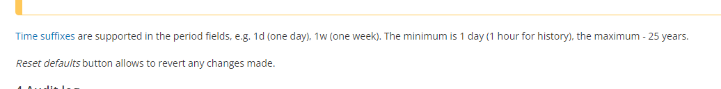

      i have nothing missed or failed to read. In the documentation there is the information I CAN use suffixes like "d" or "w" up to 25 years. And this should be "25y" and not 5x52w or 5x365d. "60M" instead of "5y" is also NOT working.
      And here is the screenshot from the documentation:

        Well that's the point I aimed for.. you can use "d" or "w" up to 25 years... not "y"... 25 years being here the maximum amount that Zabbix is working with... and you should define 1 year as 52w or 365d etc.. Want 5 years? Use 1825d or 260w...
        Click on that "Time suffixes" link there and it shows you that M and y are only usable in "trend functions"...
        As I said, it would be nice for "y" (and "M") to work also in config, but its not implemented in some reason, you can rise a request for that -> https://support.zabbix.com/browse/ZBXNEXT

          OK, I understand. But maybe the documentation should be more clear in first step. When there is an additional information for ONLY using "d" and "w" and not as an example. The wording in this case would be a first step to a solution.
          Thank you!
