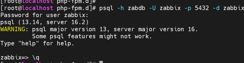

    Hi, maybe someone will have a clue what is going on:
    I can connect via psql to remote DB as per:

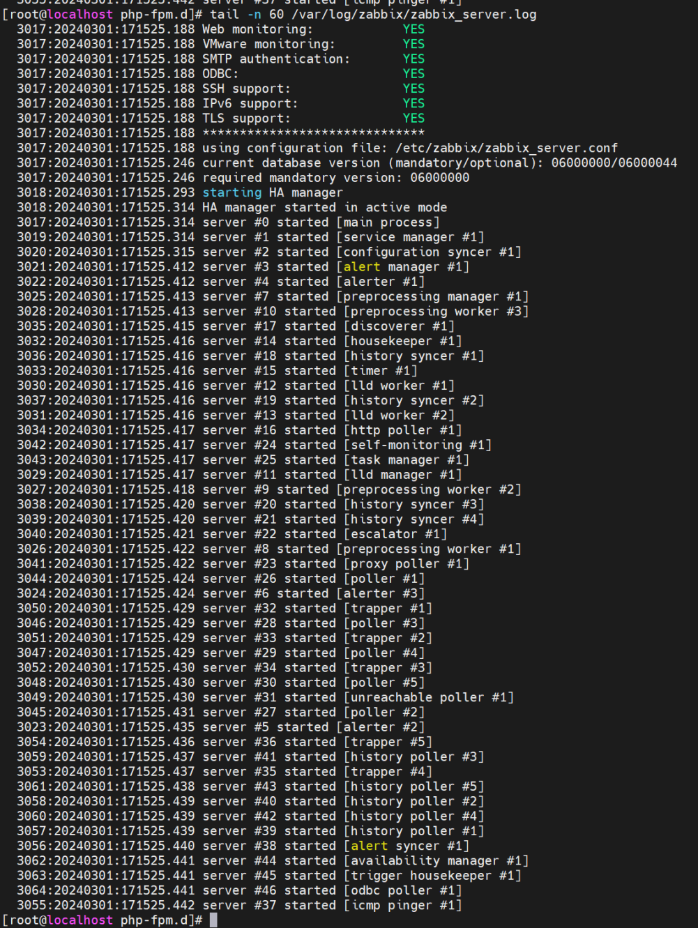

    But on frontend I get:
