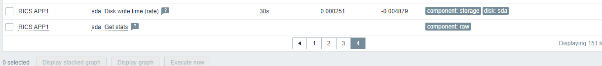

    Hello all,
    I am using the Linux agent template, in trying to monitor my Linux systems. One thing I am noticing is that the get stats for the disk is not being filled in. I checked to ensure that there is a stat file in /sys/block/sda and its got data. Why is the template not executing or not finding the file? Anyone else see this issue with their Linux systems?
    Thanks,
    Steve
Name:	Screenshot 2024-03-18 095247.png
    • 4996
    Shooting from the hip.... "get stats" is your "main" item, its contents are redistributed to dependent items and main item data is not saved to save space in DB...
    • stevefxp
      • Aug 2020
      • 168
      Can I assume that when I have a component: raw that its information is being re-distributed? What I did was look at the stat file and it matched the information that is above Get Stats....so it looks like you were correct.
        • 4996
        Yep.. raw data, that gets spread around to other items...
