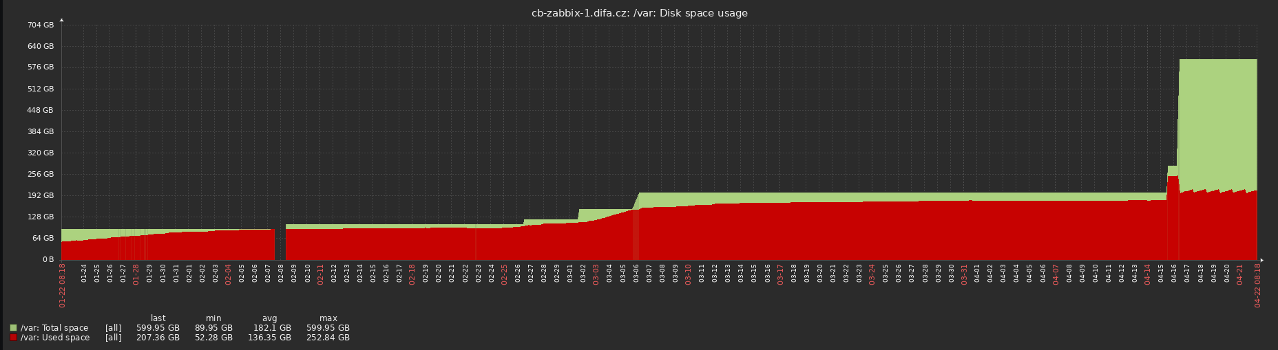

    I installed TimescaleDB for existing PostgreSQL DB for better performance and to reduce disk size for Zabbix. Before I started I had 175GB of space for database. I installed TimescaleDB with manual it was ok, but after executing this command:
    # cat /usr/share/zabbix-sql-scripts/postgresql/timescaledb.sql | sudo -u zabbix psql zabbix
    it fills whole disk space after one hour to 250GB and crashed. So I increased disk size to 600GB and execute it again, during migration disk size increased to 350GB and then go down to 200GB. After that I started zabbix server and php services. After one day DB size is 205GB... What to do now? Why is the space bigger than before? Can anyone help me to troubleshoot this?

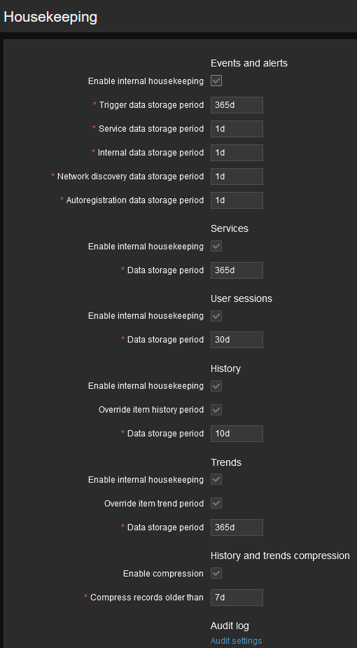

      cyber I have compression enabled, it was enabled by default. Look at the housekeeping.png.

        Based on that pic I would say, your db growth was normal. You reached the point where housekeeper keeps your DB in shape. If you do not add much items/hosts it will keep that size. For a month it has been quite stable and that sawtooth there probably shows timescale dropping older data, I have quite similar sawtooth on my instance.
