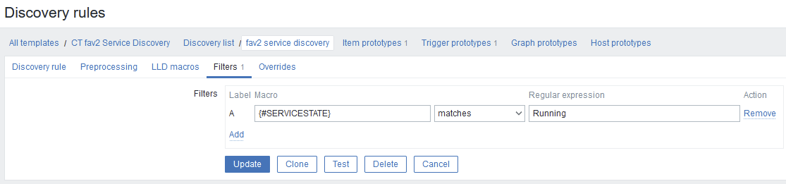

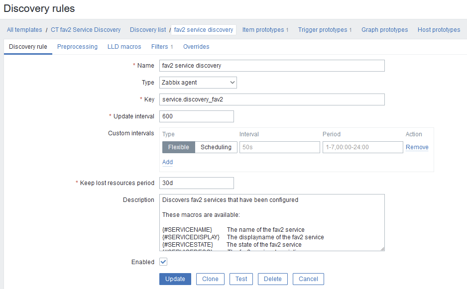

    My LLD configuration
    What is incorrectly configured or missing in my configuration?

      • 5004
      Looks ok to me... Tried to replicate a discovery here... works OK (at least feeding your data to disco results in no errors) ..
      It might be from the script ? if you call it with zabbix_get, what do you get as answer? or run locally with zabbix_agent -t ?
