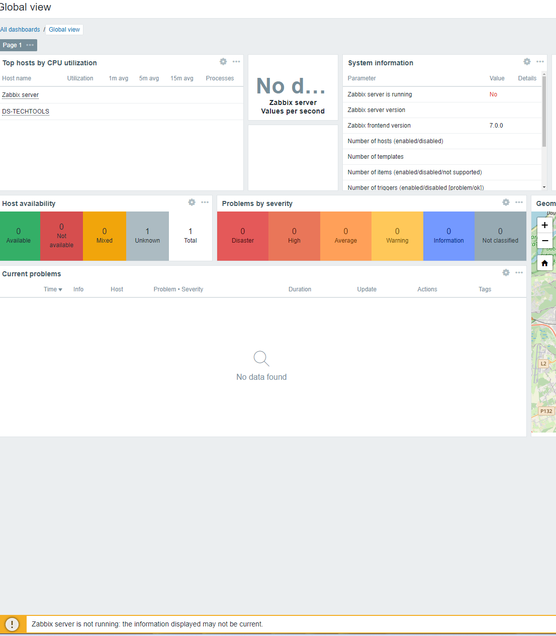

    I am trying out Zabbix for the first time and after installing Zabbix 7 onto Ubuntu 24.04 when in the web UI it says Zabbix server is not running: the information displayed may not be current. Also under the System Information widget Zabbix server is running has a value of No. I checked the status in Ubuntu and all seems good

    I also attached a screenshot of the Web UI. I have restarted the service and still the same issue. Hoping someone can shed some light on this.

    After more investigating last night I figured out my issue. Being a newbie to Linux and Zabbix what I discovered was that the # needed to be removed from the zabbix_server.conf next to DBPassword= in order for Zabbix to know how to login to the database.

      The message means that the GUI is not able to connect to the Zabbix server service port 10051.
