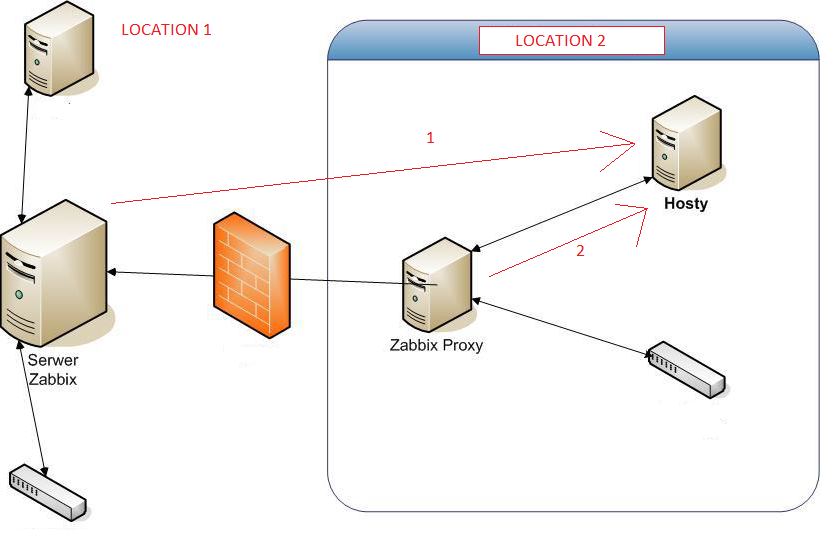

    I have problem based on this case: https://www.zabbix.com/forum/zabbix-...ng?view=thread
    Zabbix server can't see hosts behind proxy.
    Server> telnet proxy 10051 - OK
    proxy> telnet server 10051 - OK
    remote_host1 is set to monitored by proxy.
    Zabbix_Server ping remote_host1 trough interface and result is getting back from proxy - because remote proxy time is around 10-15 ms, and on these result here - is bellow 5 ms, so, I guess that pinging is trough proxy and result is getting back by proxy to server.

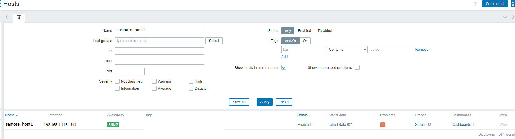

    But, on Zabbix server dashboard and Host page - seeing that host is unavailable by ping.
    Zabbix Server and Proxy versions is 6.4.4 - worked by years, but I started update OS from Suse Leap 15.4 to 15.6 and on this step - I got this problem and can't deal with it already second week.
    Could you advice me how to solve this case? - proxy was made with clean install, but zabbix server is not touched still.
