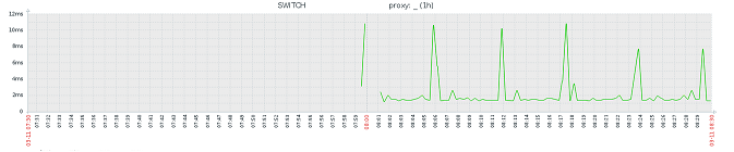

          But I have problem, The graph shows ping to the host but every few minutes is increased value. In fact, there are no such jumps. Maybe some parameter in the configuration files is responsible for that?

          • max.ch.88
            • Oct 2018
            • 206
            This is normal because there are ISP's network (maybe a lot of devices) between the Zabbix proxy and the Hosty. Ping uses ICMP to get the response time. And ICMP has low priority for network devices. Zabbix have nothing parameters responsible for that.

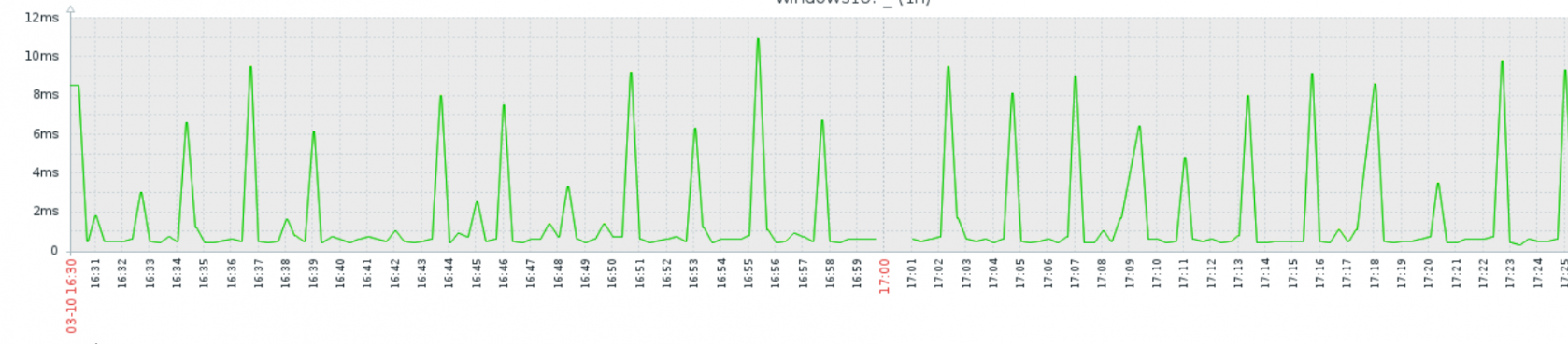

              Maybe it is. But I have another device - an internal switch. And the situation is the same.

              • max.ch.88
                • Oct 2018
                • 206
                It's some kind of network problems, not of Zabbix. If it doesn't affect on your apps, don't pay attention.
