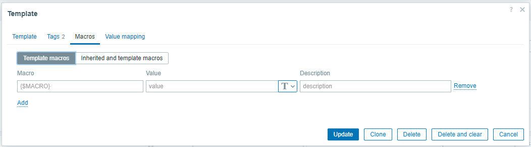

    I am experiencing a problem when I want to update or change values in a macro. WIthin a template I am opening it and switch to 'Macros' section. If I switch to the 'Inherited and template macros' there is nothing. Only a white page. When I am switching back to 'Template macros' they are all gone.

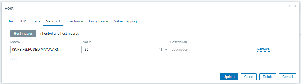

    When I want to change a macro, for example: Change warning threshold for memory to anything else, it gives me an server error. When I set the macro manually without using inherited macros section, it's working:
