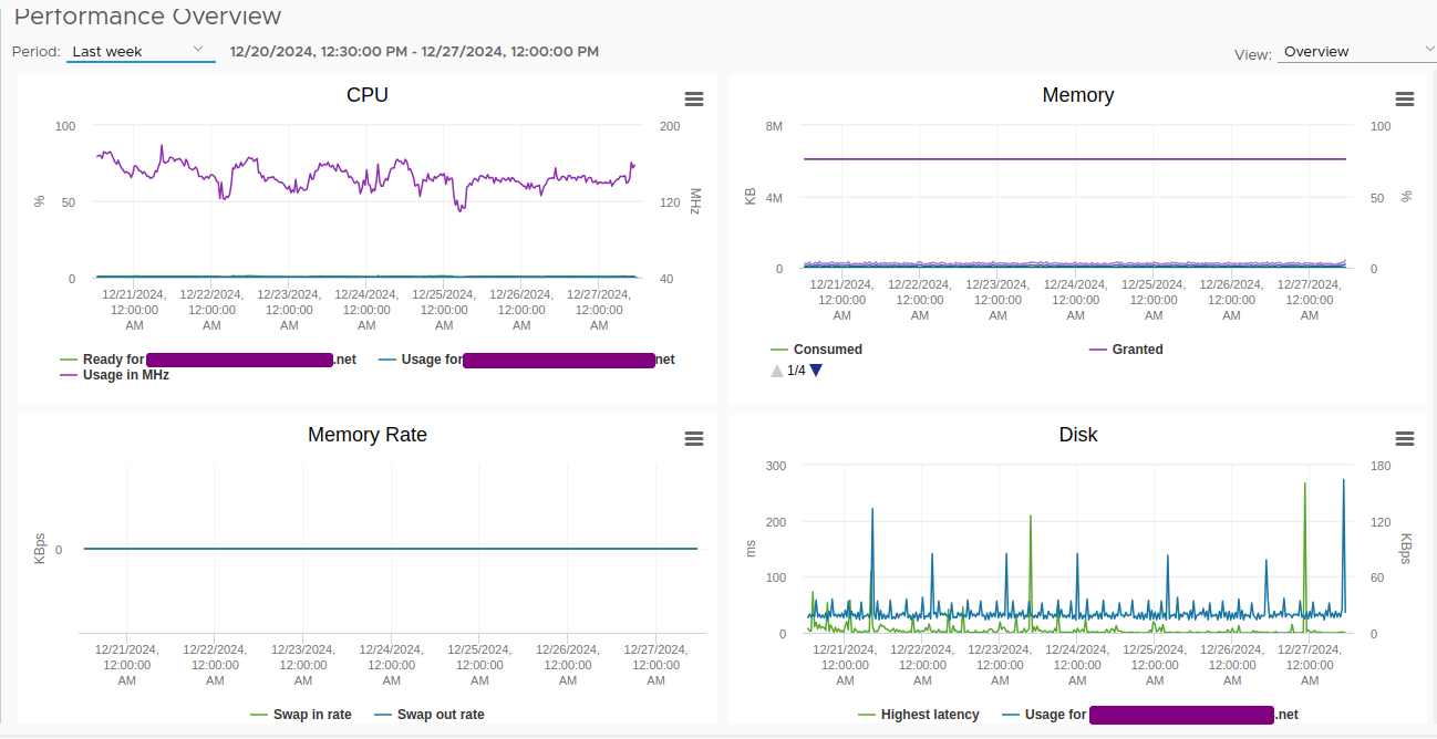

    My actually used for test proxy is very utilised. Screenshot is from last 7 days:
    My vsphere - zabbix proxy server performance:
    Click image for larger version  Name:	image.png Views:	0 Size:	109.4 KB ID:	496489​​

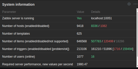

    Proxy summary:
    Click image for larger version  Name:	image.png Views:	0 Size:	15.8 KB ID:	496491​

    Your Proxy host seems to be struggling.
    Note that too many processes can be just bad as too few processes.
