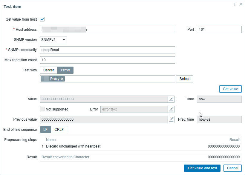

    Testing the item returns the same:

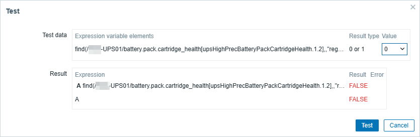

    The trigger also seems to work:

      I can't really confirm this because I don't have such a UPS to test with, but it seems that the regex in the "find" function is wrong. The trigger becomes true because the find function always finds the 0 in the octet string returned by the UPS.
      Since that is an official template, you may be able suggest improvements to Zabbix.
        • 5004
        Totally agree... that regex there "^(0)[0|1]{15}$" .. it will not match only if it starts with 1... and rest of 15 places, it may contain 0,1 or |, which also includes "all zeros"
        I think that prototype should be ...
        find(/APC UPS by SNMP/battery.pack.cartridge_health[upsHighPrecBatteryPackCartridgeHealth.{#BATTERY_PACK}.{#CARTRIDGE_INDEX}],,"regexp","^(0)(0{15})$")=0
        Then it will react, when there is at least 1 non-zero value within those 15 places... and it all starts with 0, but then it migth aswell be ".... ,"regexp","^(0{16})$")=0" same as for "Battery status not ok" trigger prototype... Just the item is different.

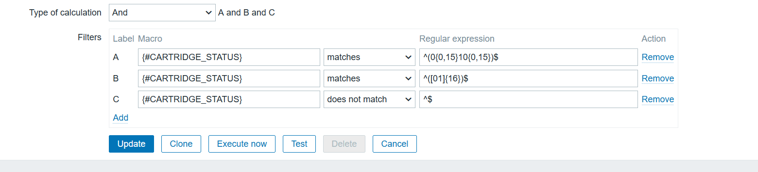

              The solution for this I've got was I modified the template to be filtered to (Regex and Regex).
              One to match that it contains only 0s and a single 1
              ^(0{0,15}10{0,15})$
              A Second to match the desired/expected length of 16
              ^([01]{16})$
              If it fills both conditions, it will be the expected 16 length of 0 or 1 while also containing at least one number 1.

              • dvt
                • Jun 2025
                Tyler's solution worked for me. I didn't have issues until I added an APC Smart-UPS SRT 3000 running firmware 16.5 to the system. My older Smart-UPS 3000 running 09.3 dont seem to have the discovery issue and stay at 26 items rather than 31.
