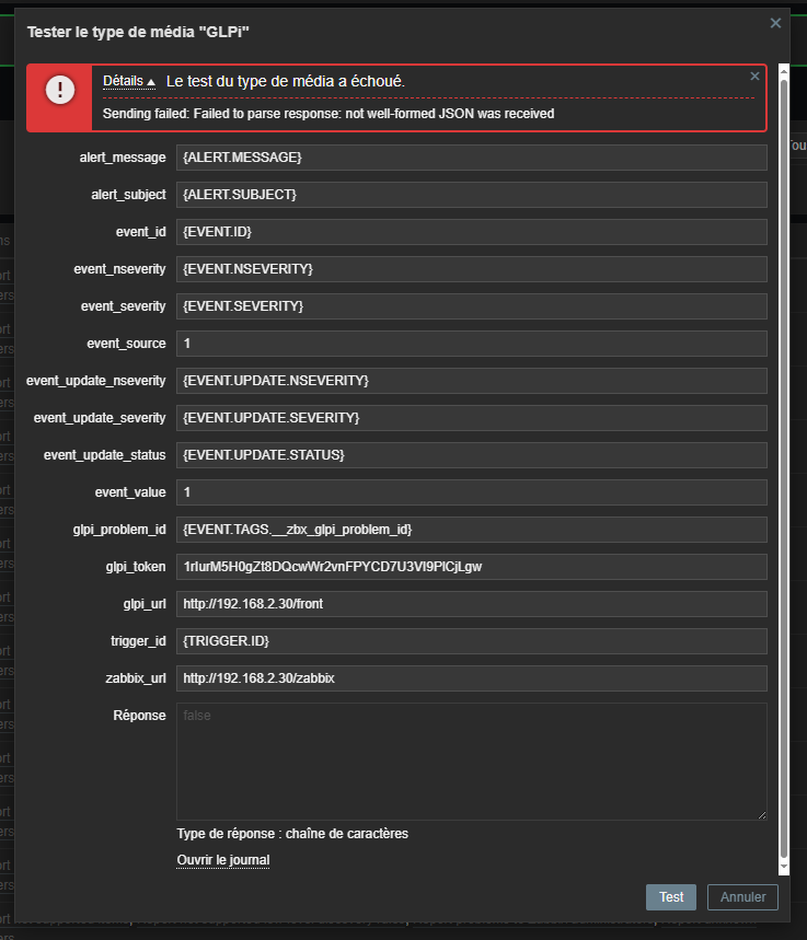

    Since yesterday, I've been trying to integrate GLPi into Zabbix. When I try to test the GLPi Webhook to create a ticket, I always get this error no matter what the configuration:
    The media type test failed.
    Sending failed: Failed to parse response: not well-formed JSON was received (screenshot below).​
    Here's the current configuration I'm using :
    Zabbix Server Version :
    GLPI Media Version :
    Webhook configuration (also tried with apirest.php same error) :
    PS: They are on the same server
    Thanks for your help

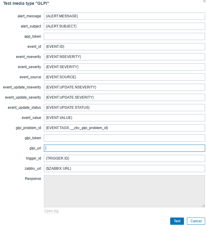

                Originally posted by cyber
                Readme says you need a user who can create/update/see problem tickets and add followups.. Even pics are attached.
                Do I have an old version? Mine saying
                In GLPi, create a user or choose an existing user - one with permission to create problems and followups.
                and also only showing screenshots for these two?
                To be sure, I've used the following: Source of README.md - Zabbix - ZABBIX GIT
                Only things you should enter to webhook config are API token and API url... (3. In the imported media, change the values of the variable glpi_token and glpi_url. )
                Also the README only works if glpi and zabbix are installed on the same host.
                Not for testing ... For this I'have to fill most fields, didn't I?
                And it is not Zabbix issue, if GLPi requires specific config for API enablement...
                You're absolutely right. I've just mentioned this, cause it think it should mentioned in the readme ​​​
                  • 4996
                  Its the same I was looking at... "create/update/see problem tickets and add followups" was taken from the picture... Reflecting the same what is written.
                  For testing, yes, you need to provide values for everything. Looking at your screenshots and logs, you have complaining about missing "app_token" there... it is not present by default... What version of GLPi you have there? docs say "tested on 10.0.16"....Maybe that parameter is from newer version? Or webhook from old times and needs update?
