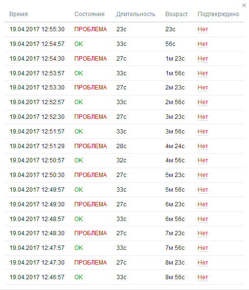

    Hi all!
    Regularly i get alert, spamming everywhere:
    Zabbix agent on hostname is unreachable for 5 minutes
    port is opened, even firewall is shut down.
    Sending zabbix_get -s 10.0.1.50 -p 10050 -k agent.ping
    works fine.
    Here's zabbix_agent.conf

    here's full zabbix log attached
  • AlexSk
    • Apr 2017
    • 10
    Here's a server log

      How often is the item being polled for the trigger?

        Hello!
        A lot of errors like:
        Zabbix agent item "vfs.fs.discovery" on host "bup" failed: first network error, wait for 15 seconds

          • AlexSk
            • Apr 2017
            • 10
            every 30-40 sec between error and restore message
            • AlexSk
              • Apr 2017
              • 10
              Originally posted by ovas
              Hello!
              resuming Zabbix agent checks on host "bup": connection restored
              What if you ping the host for a couple of minutes? No packet loss?
              yep, no packet loss at all
              • AlexSk
                • Apr 2017
                • 10
                Originally posted by sperr0w
                Wrong thread
                what do you mean?
                • ovas
                  Zabbix Certified Trainer
                  • Apr 2017
                  • 138
                  Can you try advice from the following thread?
                  https://www.zabbix.com/forum/showthread.php?t=51282 - since your screenshot is in Russian, I assume you will be able to read this. Last response from olegp is of most value.
                  • AlexSk
                    • Apr 2017
                    • 10
                    I can make screenshot in english, but there're no any items in queue =(
                    • AlexSk
                      • Apr 2017
                      • 10
                      Fixed!
                      There was a wrong expression at template:
                      {Template App Zabbix Agent:agent.ping.nodata(5m)}=1
                      it was set as
                      {Template App Zabbix Agent:agent.ping.nodata(5)}=1
                      as a default
