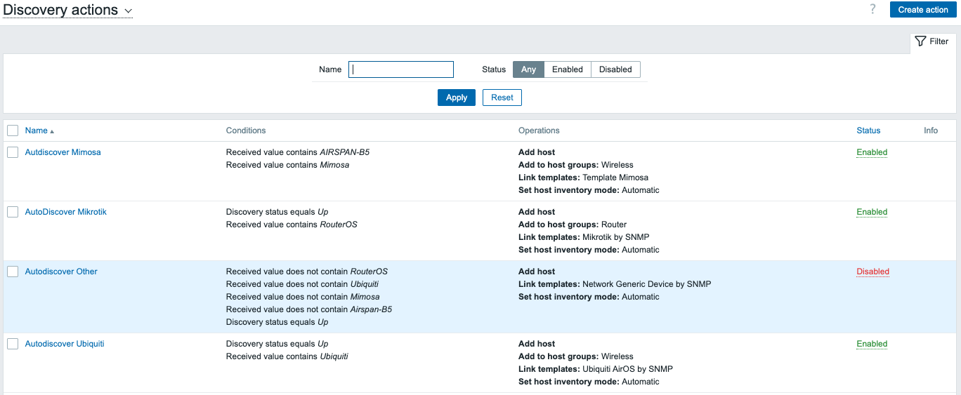

    Running version 7.2.4. It looks like Alert>Discovery Actions using received value contains with service type SNMP isn't working as I thought it should. I'm trying to use it to link a template according to the type of device it is. So if I set Received value contains Mimosa it doesn't work and falls through the the generic catch all action of Network Generic Device by SNMP. If I use or in the action and list out each possible name it may find, the action then works. Same for other types of hardware such as RouterOS. I would have to list out each type of mikrotik using or. Using a snmp get on the ORI shows something like SNMPv2-MIB::sysDescr.0 = STRING: RouterOS RB4011iGS+. I would think that "contains" would catch RouterOS in that and apply the action.
    What am I missing or is this a bug?

      Thought so, it doesn't. Tried it against several types of equipment where the value will vary according to model and the only way I can get a correct action is to "or" each possible value. So bug it is I think.

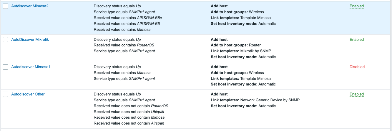

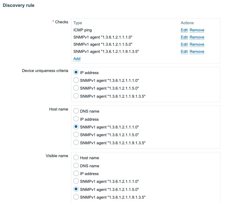

          I define my Discovery Rules according to location. IE: Tower 1, Tower2 etc. I've attached a screen shot of one of those Discovery rules. Basically all the rules use the same items but different IP addresse ranges. Since I have a mixture of old and new equipment I am using SNMPv1. Ubiquiti uses v1. Since I couldn't get them to work with a mixture ov v1 and v2 I went with v1. The values are to display what name the host is and to apply the proper template.
          In the Actions discovery I look for the value then assign the proper Template. Also a screen shot of that showing four different items.
          Autodiscover Mimosa1 did not work and it would fall through to Autodiscover other. So I disabled that one.
          Autodiscover Mimosa2 works using "or". I listed the complete values I see when a do a snmpget of the OID for different Mimosa equipment.
          Auto discover Mikrotik does not work, it falls through to the Other action. When doing a snmpget on the OID for those, the return is something similar to what I showed in the initial post above depending on the model. Click image for larger version

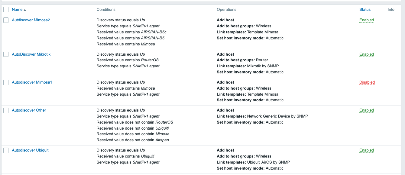

            I checked on one other item, the Ubiquiti action and it appears to be working. I am attaching a new screen shot of the actions which has it included. An snmpget of that OID is:
            .1.3.6.1.2.1.1.9.1.3.5 = STRING: Ubiquiti Networks MIB module
            So I am not sure why that on is working but the others are not.

                Based on the discovery rule configuration you shared, your host names are set as the system description (1.3.6.1.2.1.1.1.0). Is this what you are aiming for?
                Shouldn't it be "sysName" (1.3.6.1.2.1.1.5.0)?
                You could try removing the "Service type equals SNMPv1 agent" condition (I've never had luck with it). Change it for the "Discovery object equals Device" (but not really necessary).
                Then, check your action "Type of calculation" and try customizing it. I think you might be mixing up the "Received value" condition with "Or".

                      Markfree, your question about the hostname, for now that is what I intended so I can see easily what values were returned. DNS is not in play here so doesn't matter.

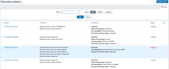

                      So did some more testing and basically getting the same results. Attached screen shot has the current Action> discovery. Everything in each of the Discovery Actions is "and" except the Mimosa action which is or between the to "contains'. I've disabled the "Autodiscover other" action for now to keep from having a bunch of warnings between test changes.
                      For clarification, each of the Discovery Rules covers the IP subnets on a particular tower. Each tower has a mixture of hardware so Autodiscover actions are trying to apply the correct template to that particular hardware manufacturer if you will.
                      As it stands now;
                      The Autodiscover Ubiquiti applies only the Generic network which is not correct.
                      The Autodiscover Mimosa applies both the Generic network and the Mimosa templates. It should only apply Mimosa.
                      The Autodiscover Mikrotik applies only the Generic network template which is not correct. It should apply the Mikrotik template only.
                      Cambium equipment has the Generic network template applied which is what I would expect.
                      Various switches have the Generic Network Template applied which is what I would expect. Click image for larger version  Name:	DiscoveryActions .png Views:	12 Size:	119.2 KB ID:	502948
