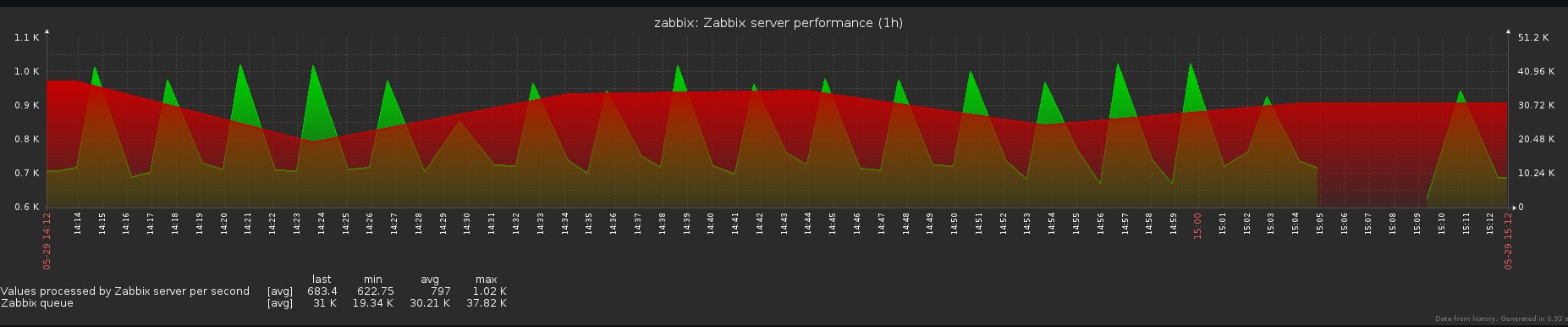

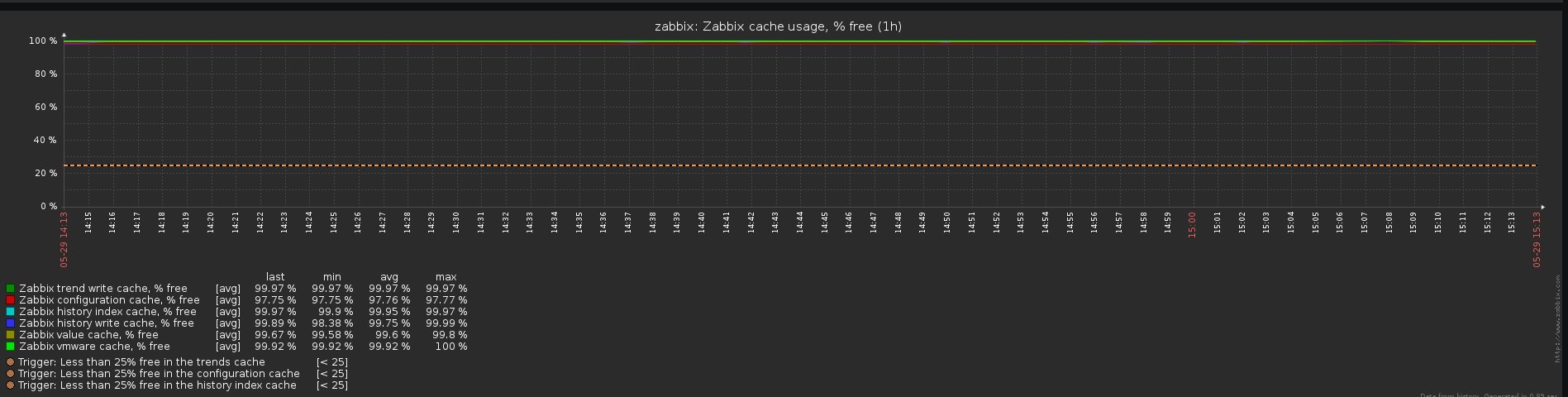

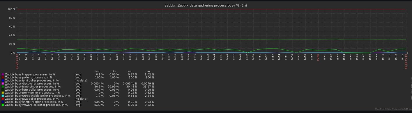

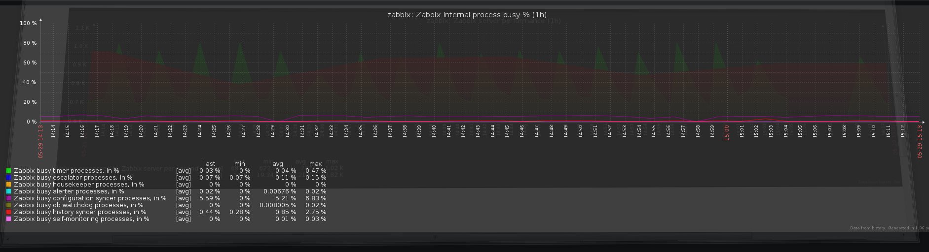

    Are you able to provide the following graphs?
    • Zabbix server performance
    • Zabbix internal process busy
    • Zabbix data gathering process busy
    • Zabbix cache usage
    I mean, there must be some clues for such behavior. Have you tried inspecting database performance?

        The Zabbix server internal process/caches indeed look good... For 1d and 7d the usage patterns remain the same?
