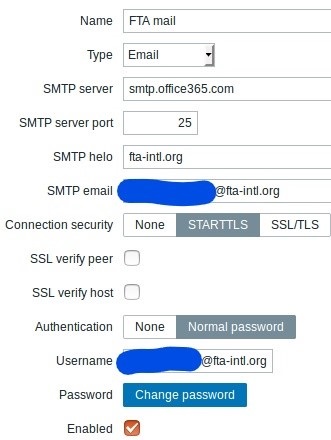

I'm having issues setting up mailing to office 365.
I've read a good few threads on setting it up, and I think I did so correctly, but somewhere I must have screwed up...
In the Action Log I get the result [Failed] with this info: [Login Denied: Connection timed out after 40000 milliseconds].
Please refer to the attached image for my config.
Port 25 is open, refer to PowerShell NetConnection result.
