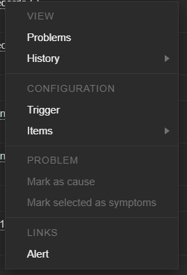

    For us, all triggers, which are tagged appropriately, will be sent out to 3rd party system over the webhook. successful posting returns alert_ID. Webhook script parses it and adds it as tag to event.. and then we have in webhook config this menu config
    and then you get a menu entry in problem
    Not exactly what you wish, but maybe helps a bit.. ​
