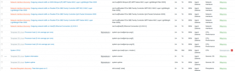

          I have the same problem as zjsbayona ' system.cpu.load[<cpu>,<mode>] ' Invalid first parameter ... I haven't access to log zabbix "You do not have the permissions necessary to open the file" I have a correct connection with zabbix agent. I have set Server and ServerActive Ip in file agentd.cong .. Host is Avability ..
          I will be very grateful for tips !
          • aigars.kadikis
            • Mar 2018
            • 208
            You have to remove those fields containing '<>'. Triangle brackets means that this field is optional.
            Use one of following keys instead:
            system.cpu.load
            system.cpu.load[]
            system.cpu.load[,]
